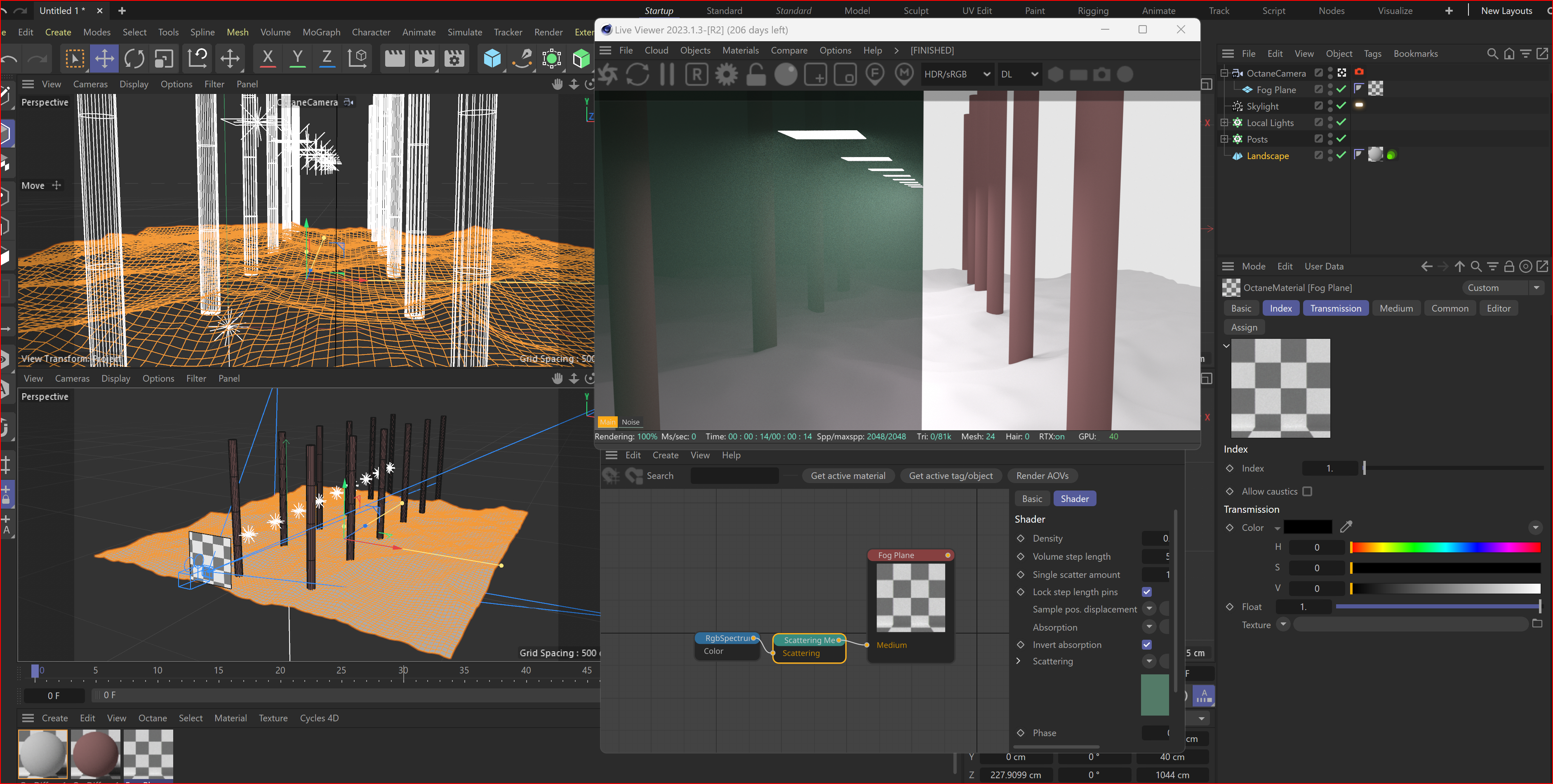

I'm still a big fan of the 2D Specular Plane hack. Place a plane to cover the camera's FOV. It can be quite small, and a child of the camera object. Make a Specular material with both an IOR and Transmission of 1. Add a Scattering Medium to the plane and you've got a simple, fast volumetric fog that interacts with lights (glows, god rays, etc.) and that can be moved a set distance (and scaled accordingly) from the camera to determine the starting range of the effect.
This trick was broken for a while in some older version of Octane, but it works again, at least as of Octane 2023.
There are lots of other, more refined ways of doing it, but as a quick 'n' dirty trick when you just need to get it out the door fast, it works wonders. Here's a simple example. This is not a split A/B render comparison, but a single render with the "fog filter" positioned to only cover the left half of the frustrum. It works for murky underwater shots, distant landscape haze, whatever.
great little trick, will be using this over the box version from now on! amazing, thanks!
