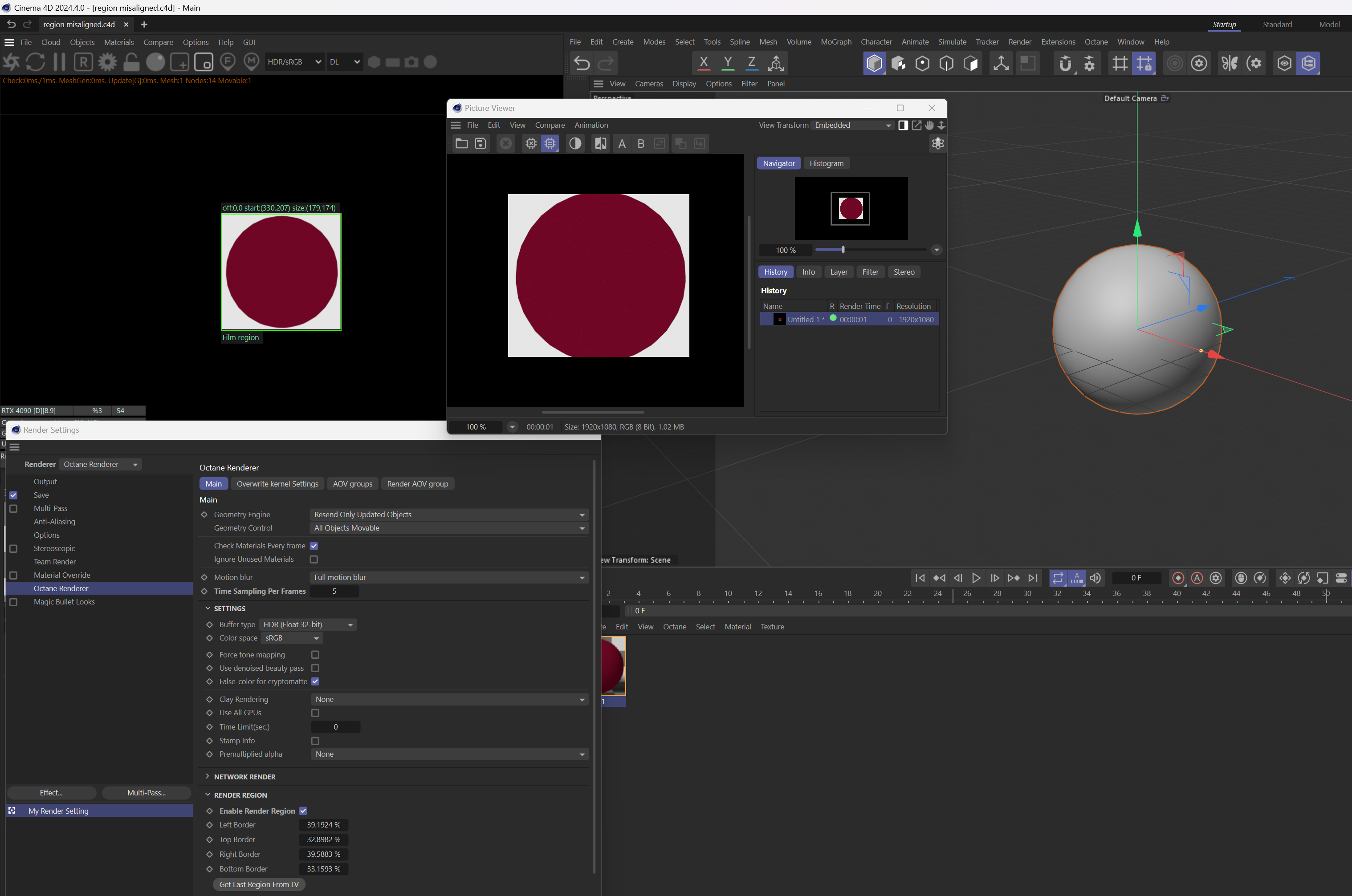

Add a sphere
draw a render region around it
enable the region in the render settings
click the "get last region from LV" button
Render to picture viewer
The rendered image does not match the region which was drawn.
In case its relevant, I am using 150% windows UI scaling on a 4k monitor
file attached
win 11
c4d 2024.4.0
octane 2023.1.2 R6
150% windows scaling
render region misaligned

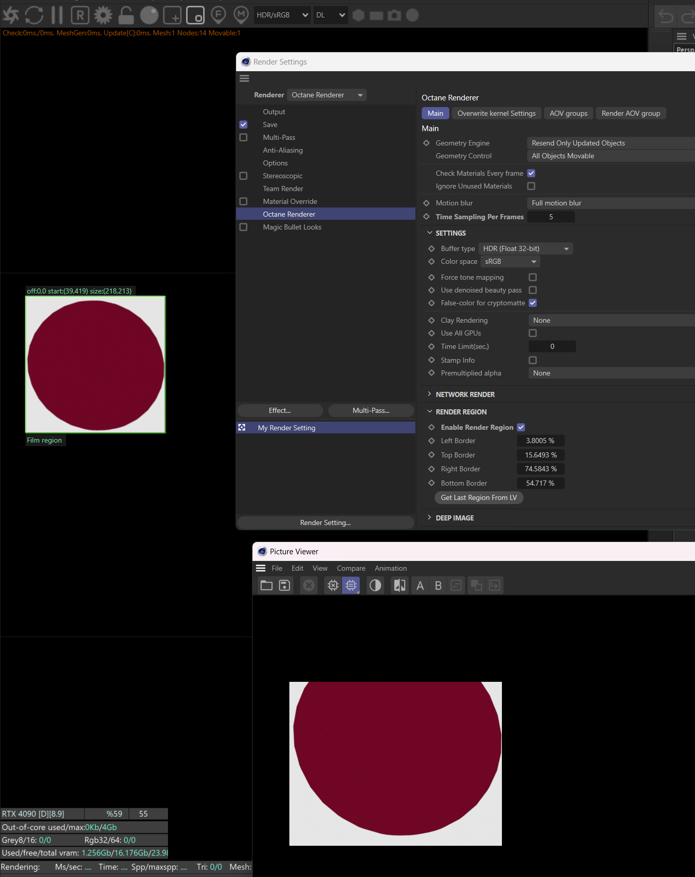

Ive updated to R7 plugin, still a problem. Try a taller live view window which is docked into the c4d UI and also try 125% scaling. Also try uncentering the sphere. Here's an extra bad example for me using 125% scaling, as soon as I set this back to 100%, everything lines up again. c4d project attached

Ok, I can confirm the issue, thanks for the report.
