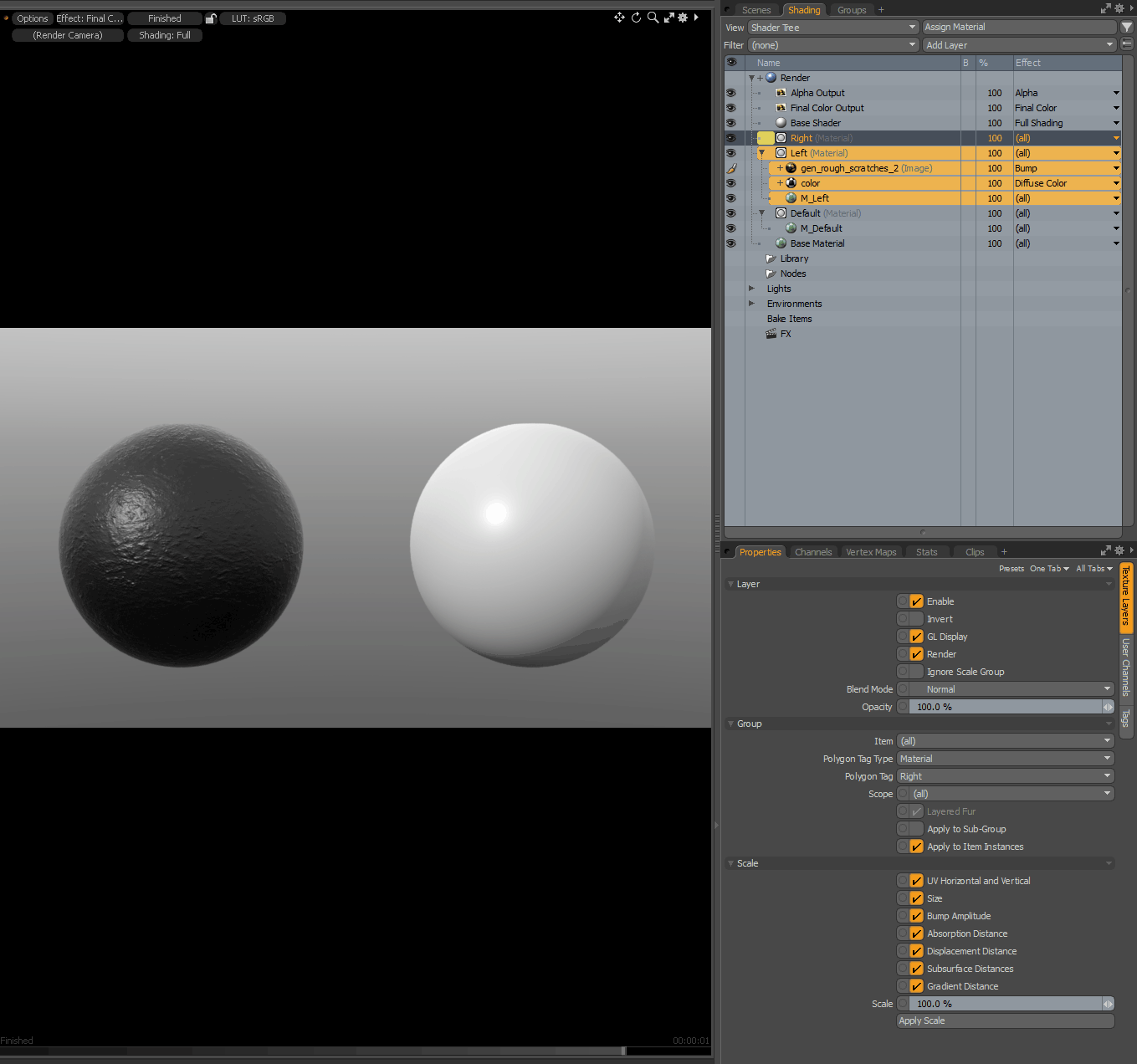

If one channel of the "instance octane overdrive" > instance is manipulated it also changes the source.
what i would expect is:
change within the instance does not change the source, while change in the source does effect both.

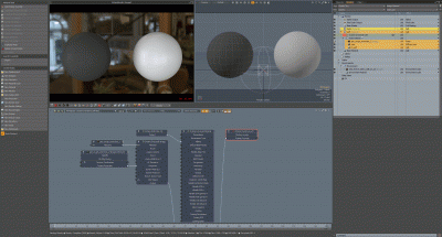

steps to reproduce:(see octane_instanceshort.gif)
create 2 speheres. each with it own material tag. (Left / Right)
create 1 octane override in (Left)
Use "Instance Octane Override" and move it in Material (Right)
change color node within the instanced octane override.
>>> both spheres change color.

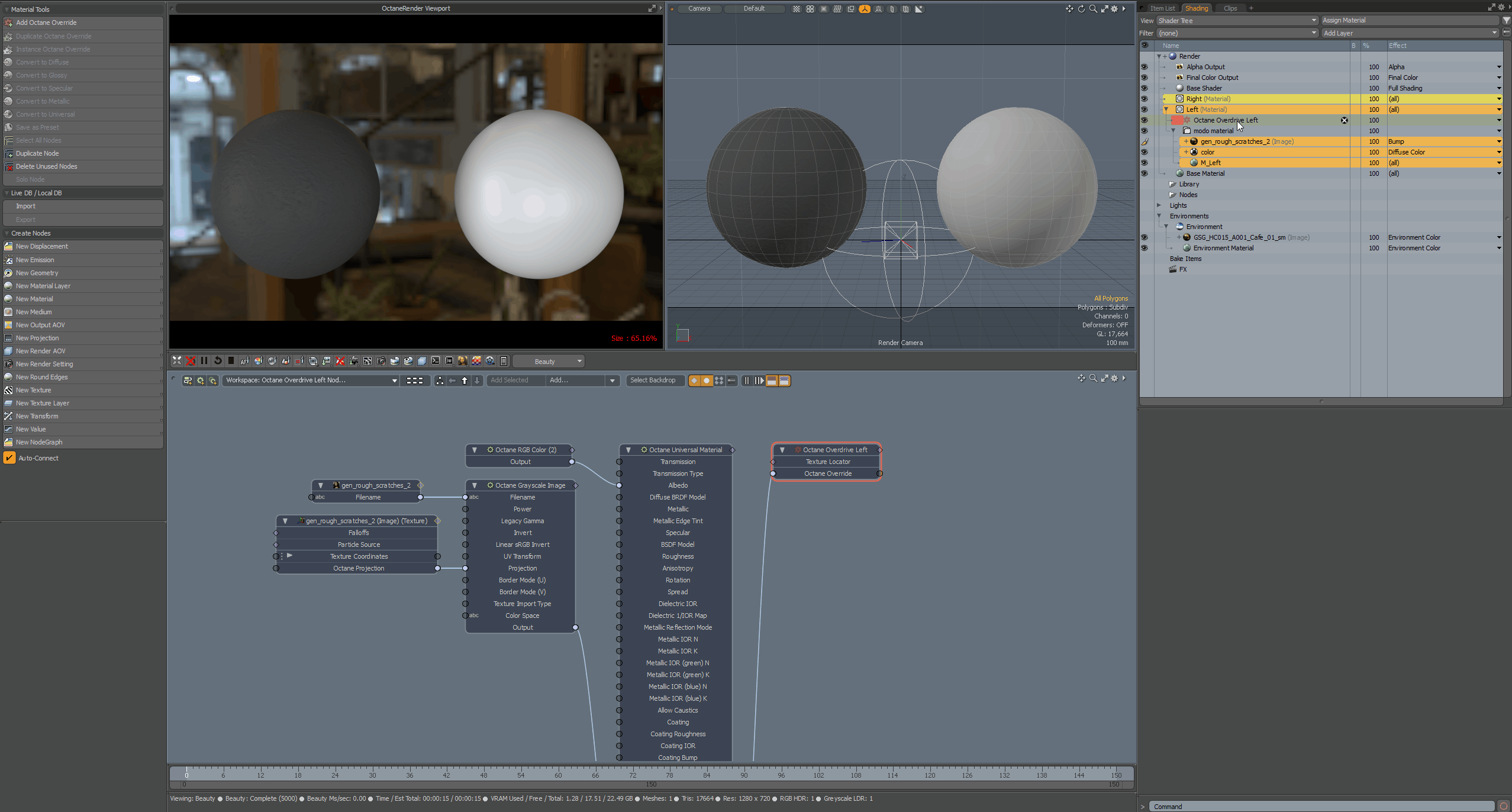

see modo_instance as reference how it should be.
i can change the color of the instance only while still change roughness in source for both.
win 11 | modo 17.0v2 | studio+ 2023.1.2.199

If you look at the modo_reference I've attached, it's clear that I can change the color of the instance independently of the source, but still have the ability to change the roughness for both when using the source.
this is not the case with the "instance octane overdrive" because any change in the instance is propagated back to the source.

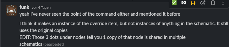

as @funk mentioned on slack. the three dots under the "instanced" nodes show that this node is already being used elsewhere. so i would say that the "instance octane overdrive" is creating the wrong kind of node while it is running.

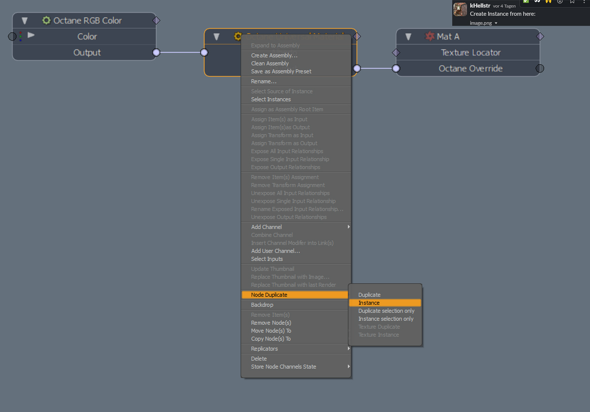

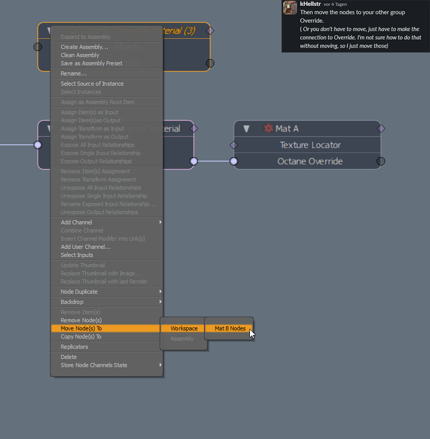

@khellstr shows a manual workaround for this with the real instanced nodes.... thread>https://foundry-modo.slack.com/archives ... 9440414609
