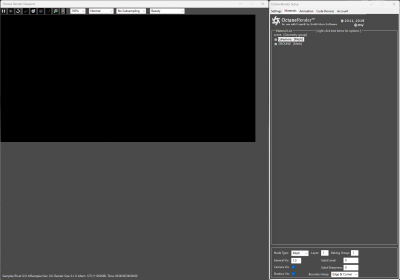

I changed my computer recently and the plugin does not work anymore. I use the same graphic card, the same poser version, the same octane version and the same plugin option. Octane standalone works fine but not the poser plugin. The plugin opens normally, but when I start to render the samples/pixel and MSamples/sec values stay at 0/0. I can select the materials in viewport and in the material tree but the viewport stays black. If I export the scene in octane standalone, it works fine. In this example the scene is just the default poser scene.

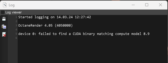

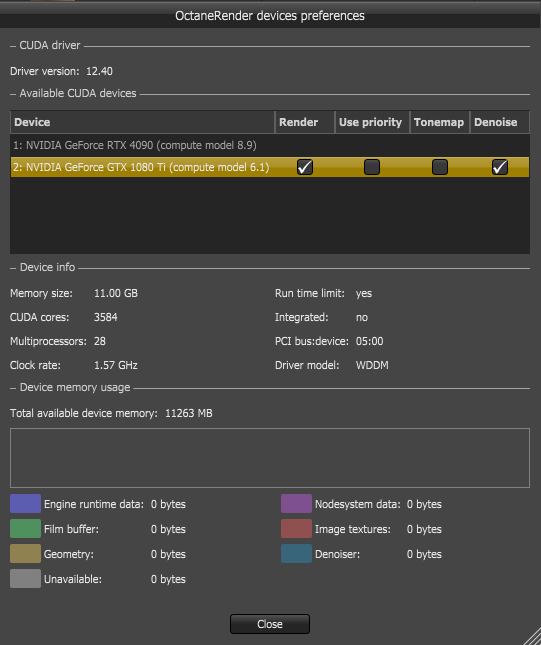

I attached the log and the device settings. There is an error in the log because I think it tries first to deal with my RTX4090. When I disable my RTX 4090 in the Windows device manager, there is no more error but the plugin still does not work.
