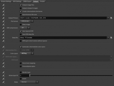

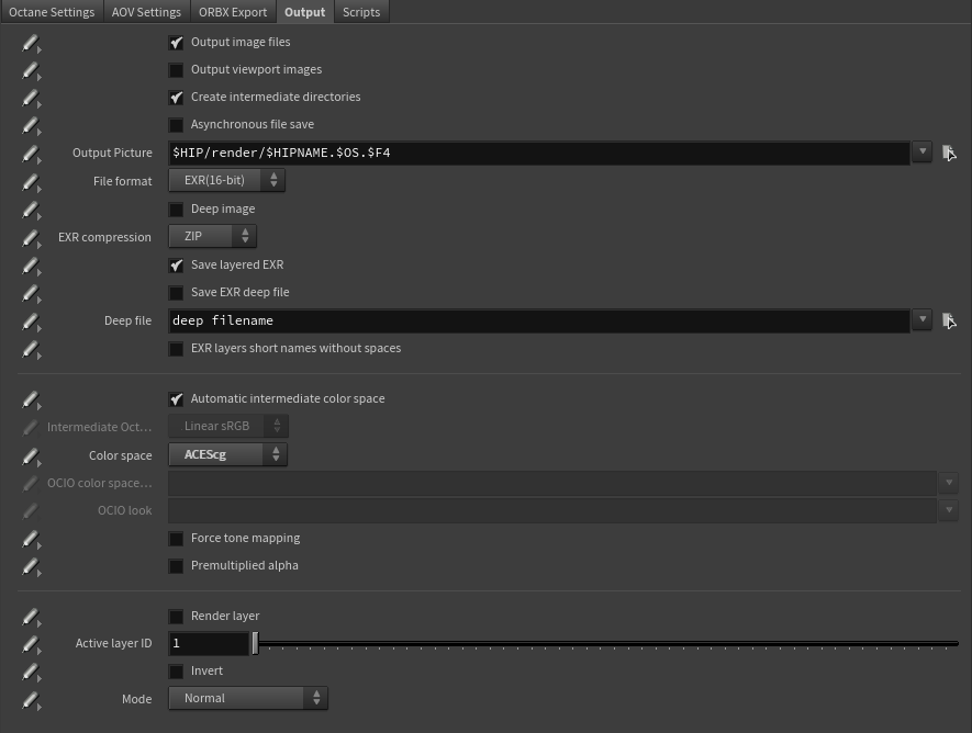

Still need to dig into this a little more but I think the Color space parm on the Octane render settings LOP is not being honoured when either writing a file to disk directly from it, or more importantly for us exporting orbx files. It looks like it will render/create an orbx in Linear sRGB even if explicitly set to ACEScg.
I'll build a repro file if I can but I run into (nearly) all of these issues in production so sometimes it's hard to find the time.

adrianr wrote:Still need to dig into this a little more but I think the Color space parm on the Octane render settings LOP is not being honoured when either writing a file to disk directly from it, or more importantly for us exporting orbx files. It looks like it will render/create an orbx in Linear sRGB even if explicitly set to ACEScg.
Hi Adrian,
Thanks again!
Yes, a sample scene would help a lot.
Just to confirm if you have the *ACES tone mapping* option enabled from the Camera>Imager when you save the built-in ACEScg!
For Viewport render Hydra requires a Linear image input, so the tone mapping is done by Houdini.
