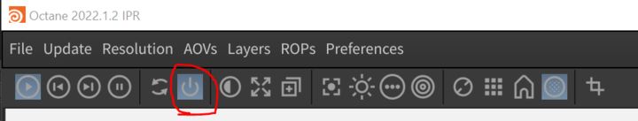

The logs aren't really showing an issue... Can you try the other render window the QT5 one then also try the "Disable Scene Updating".

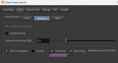

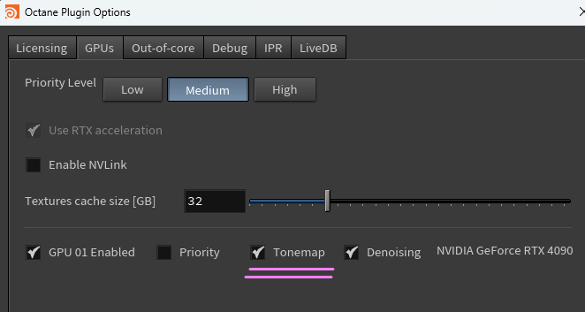

Please check that Tonemap is ON, under the GPU options.
snakeboxmedia
Posts: 140
Joined: Wed Jul 11, 2018 1:09 pm
Hah!! YES!!!! the tonemapping did it!!
So I'm guessing its on by default in 2023 but not in 2022? I had to tick it for both my gpu's but yes, it renders now... what a random error. Good find!
