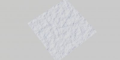

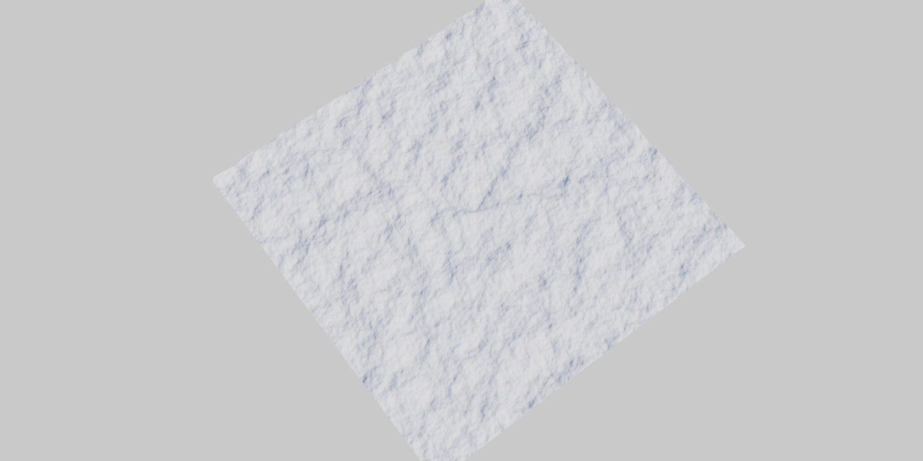

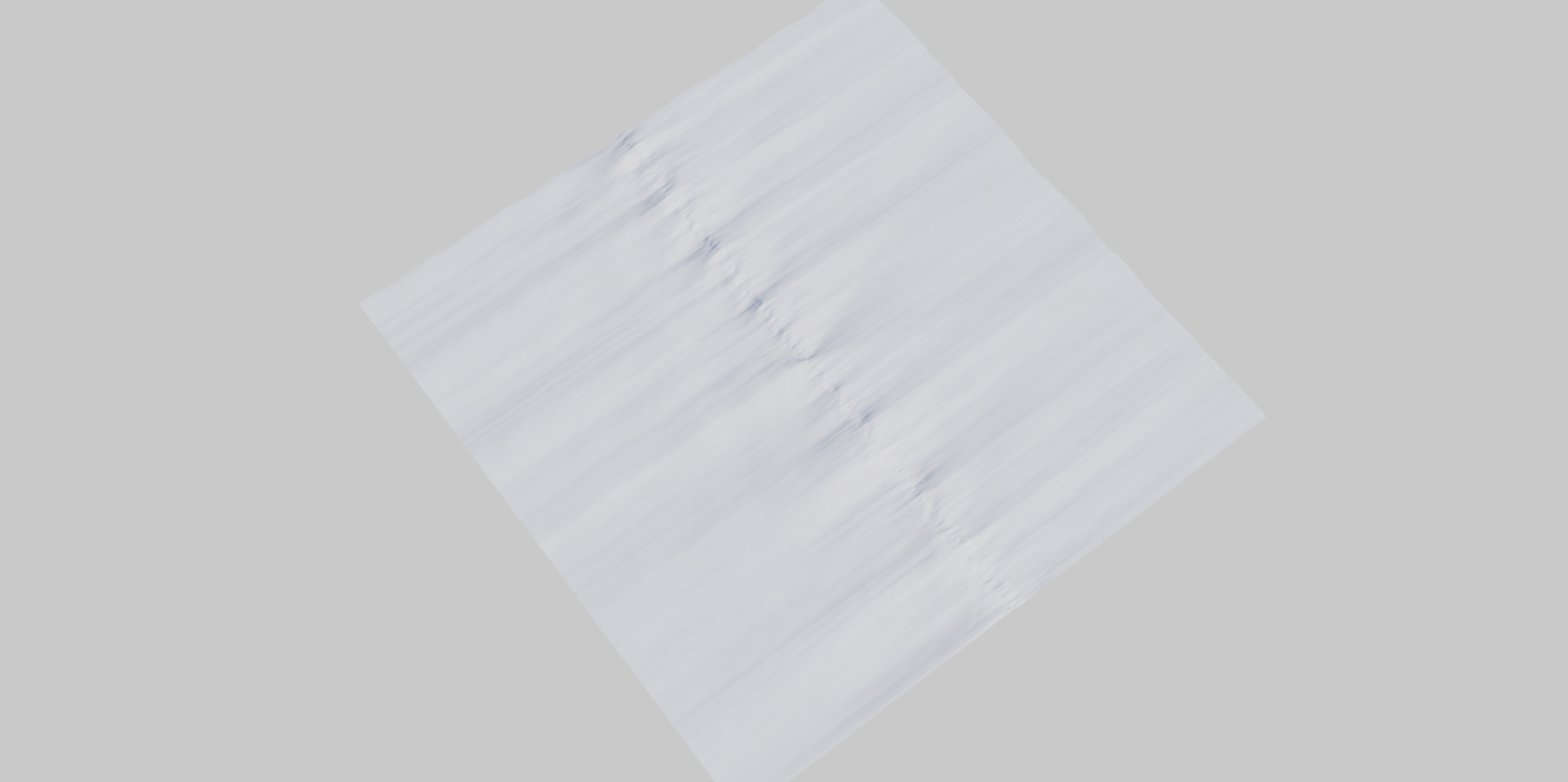

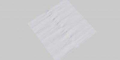

Auto bump map in vertex displacement is broken. Works fine with images, doesn't work with noises. Works just fine in standalone.
auto bump OFF
auto bump OFF
auto bump ON
auto bump ON
displacementTest.zip
(9.99 MiB) Downloaded 171 times

galleon27 wrote:Auto bump map in vertex displacement is broken. Works fine with images, doesn't work with noises. Works just fine in standalone.
Thanks for reporting this and giving a sample scene - it is appreciated!
We will investigate, for now you could add a bake to texture node in between the noise and displacement.

Looking now, this seems like it is an issue in Standalone 2023.1 but not 2024.1 alpha with the Noise + projection: XYZ to UVW
Add a UV Mesh Projection onto the Noise node and it will work.
