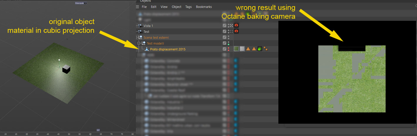

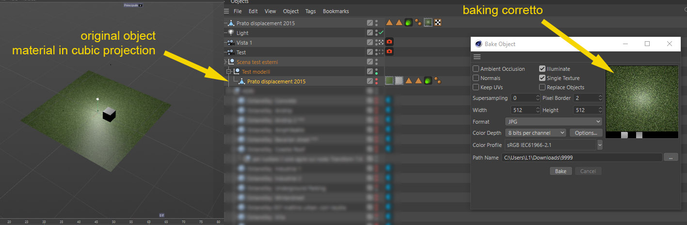

Trying to explain myself better, here the result with a simple object (a plane and a cube), connected as one single object:
using "Cinema4d bake object"
using Octane Camera in baking mode:
i9-10900x, 96GB DDR4, 2xRTX 2080 TI, ASUS X299 SAGE, Windows 10
