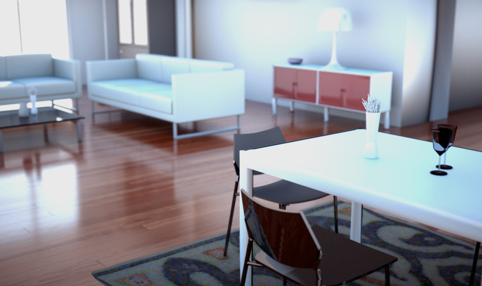

First interior and question about Blender-Octane

HUUUGE welcome to you!
As steveps3 said, you definitely won't be disappointed.
Octane changed my rendering experience and opened a brand new world of possibilities to me.
As you get along, you'll definitely see how powerful it is.
And I also never use the Blender internal renderer engine anymore = once you've tried Octane you just can't get away from it!
Looking forward to more pics from you!
