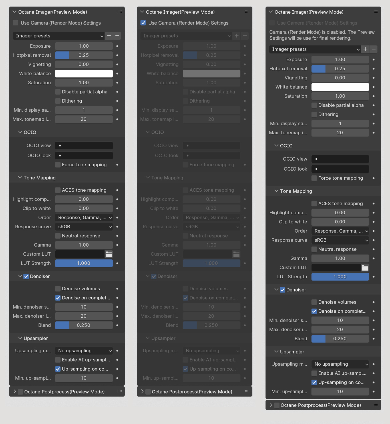

OK. Here's one final attempt to find a way out of this maze ...
Thoughts ...
*) Whatever is set in the preview settings should stay consistent no matter if I'm in perspective view or if I look through the camera. It's all considered preview and the different viewpoint or focal length of the camera doesn't change that. Otherwise you will always have weird perceptive changes. In my case it would always switch from sRGB (Preview) to AgX (Render Mode) and the Denoise would switch from OFF (Preview) to ON (Render Mode). I don't need either of them in Preview.
*) The checkbox in the Preview panel should go. It has no real purpose and will add an unnecessary layer of confusion in combination with the checkbox in the Render Mode panel.
My suggestion ...
I've attached a mockup. As you can seen the parent panel checkbox is gone and I added checkbox inside the panel. If that checkbox is checked, the panel content is greyed out and the active camera settings are used for the preview - again for perspective view as well as camera view. IF the checkbox in the Camera Imager (Render Mode) panel is OFF (no settings for the camera are defined), that checkbox "Use Camera (Render Mode) Settings" has to be deactivated as it would not make sense. Instead an info text could be displayed.
So here are the scenarios (red is unchecked - green is checked) ...
"Use Camera (Render Mode) Settings" - Camera (Render Mode) panel
Preview shows whatever is set in the Preview panel. Final rendering uses Preview settings. (An info text could indicate that)
Preview shows whatever is set in the Preview panel. Final rendering uses Camera (Render Mode) settings.
Preview shows whatever is set in the Camera (Render Mode) panel. Final rendering uses Camera (Render Mode) settings.

Hi Lino,
I love the idea the Imager/post is easily accessible in 3d viewport window. This makes any changes to the look of the image quick and easy. Please don't remove it from here.
Still there are two major issues that could be resolved to make the workflow simpler:
2. If I disable Preview mode and Imager on camera is enabled, Imager on Camera object works but the options are grayed out. <-- new bug
Hi Andreas,
you suggestion is still way around like it is currently. You have to manually disable Imager in 3d window to make the Imager in Camera object work. What if I have more cameras in the scene? Your solution is ok with one camera but it is not usable with many cameras as not all cameras in a scene need a separate imager. Disabling Imager for all cameras in a scene will add unnecessary work to to adjust settings in all cameras instead using one global settings.
1. Imager on camera object says "Render mode". It will not work if even if it says Render mode. If preview mode is not disabled "Render Mode" won't work for final render. If the panel in 3d viewport is hidden you may not know that there is a switch you have to disable.A the moment if I enable an imager in Camera settings it does nothing. I have to disable "Use for all cameras" in 3d viewport to make it work.
Now go to Cinema 4d and see how it works. There is a global Imager settings for all cameras and each camera can have an override for global setting. I can have 3 cameras with same settings controlled by global Imager and one camera that has different settings. Not the way around.Imagine I have 4 cameras in a scene. Camera 1,2 and 3 can have same exposure setting while camera 4 needs different exposure. If I wanted to use different exposure for camera 4 I would have to disable "Use for all cameras" and adjust settings for all cameras instead of one camera. If global override worked I could adjust exposure for camera 1, 2 and 3 with one imager settings (global) and adjust exposure for camera 4 using its own Imager settings (override).
Hi Andreas,

Hey, JC.
You've either misread my suggestion or I haven't made myself clear enough. But what you write does not apply. In my suggestion you can't even disable the imager in the 3D view. So I don't understand what you mean.
Hey Andreas,
let me get this sorted:
Why do you call it preview when it will work for final render?
In general to disable settings in 3d viewport panel it is better to enable override in a specific Camera object. This way other cameras will still use settings from 3d viewport panel.
This makes sense, but there is no switch to disable Imager completely. In general you should be able to disable Imager completely. You solution does not allow that."Use Camera (Render Mode) Settings" - Camera (Render Mode) panel
How do I see/adjust changes from Imager in Camera Object settings? Do I have to enable the imager in all cameras or will it use the settings from 3d viewport panel?"Use Camera (Render Mode) Settings" - Camera (Render Mode) panel
