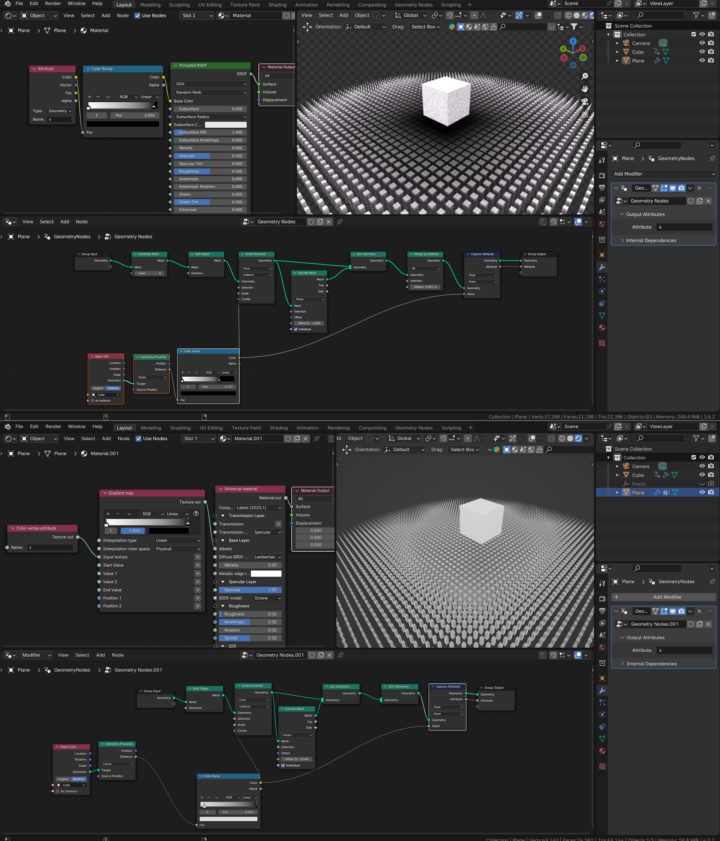

In Octane 28.10, I'm facing issues accessing color attributes from geometry nodes, dynamic paint, and the vertex weight proximity modifier, which all work in Cycles. Any advice?

In regards to your screenshot, replace the node "Capture Attribute" with "Store Named Attribute". Set the dropdowns to "Color" and "Point" with the appropriate attribute name and you'll be good to go! Refer to the screenshot above.

Thanks for providing the solution, it's working perfectly now.
