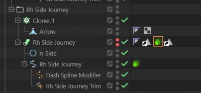

In the project I am working I am using two capsules which Maxon has released, the Trim Spline Modifier and the Dash Spline Modifier.
Trim works great with the Octane Object tag and set "Force Updates" to Enabled. All works within the local IPR window but when sending to the multi node render farm it just renders one arrow. I have norrowed it down to the Dash Spline Modifier as the Trim works well on the farm and locally.
Anything to sort this problem out?

Looks like the issue is with Cinema 4D Commandline as having issues with a viewport network rendering.
