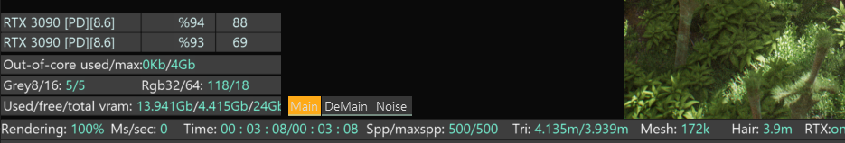

Thank you for the suggestion. Here is the log from 2 Render Queue frames. I have also included a screenshot of my live viewer data.
The first major thing I can notice is that through the render queue it is dumping a bunch of stuff into the out-of-core memory and in my live viewer it isn't using it at all?
Live Viewer Data Screenshot

You'll see some big differences on amount of triangle counts in PV if you carefully compare the data.
LV: 4.135m mesh triangles/3.939m displaced triangles
PV: 12.579m mesh triangles/19.88m displaced triangles
This may cause OOC used. Low VRAM.
Also on start of a render, it create/resend materials, motion data, polygons. These are high on first frame.
55 sec. for materials
18 sec. for motion blur data
