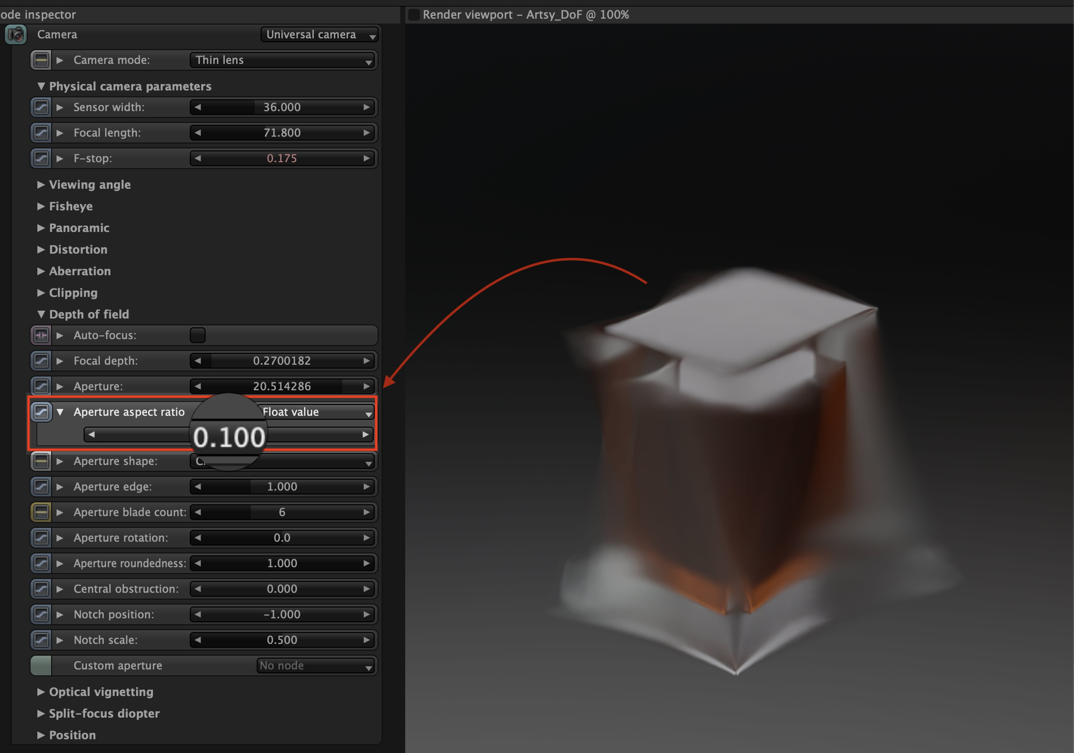

Not sure how the effect is obtained, but please have a look at this video on how to use Motion Blur in a creative way to have a similar result:
https://youtu.be/2Q_s9segSx4?si=AZc3yfKiVOFyBbjM
