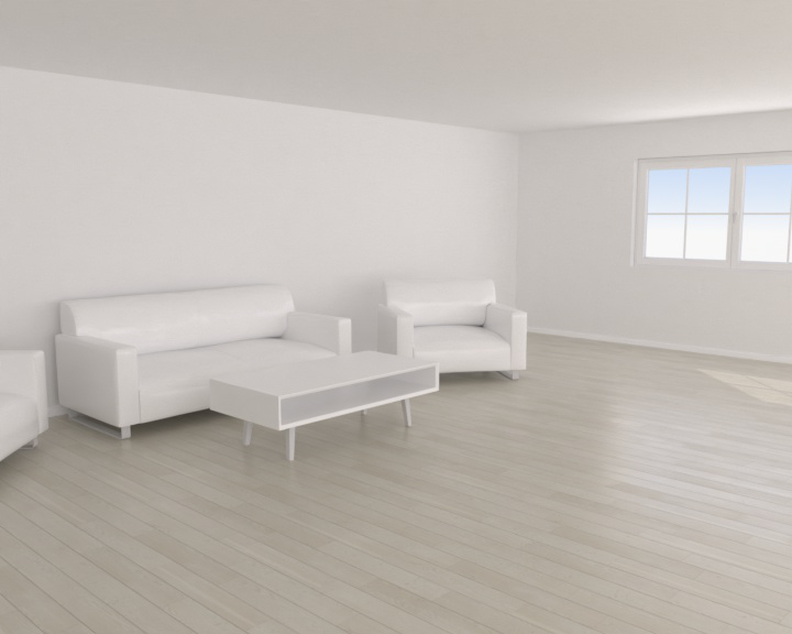

I have a little Export Problem with Octane.
I cannot save the rendered Picture into JPG.
I got a Overexposed Picture and just set the Settings does not work. Project/Raw or Disable.
Whats going on ? I am using the Standard ACES.

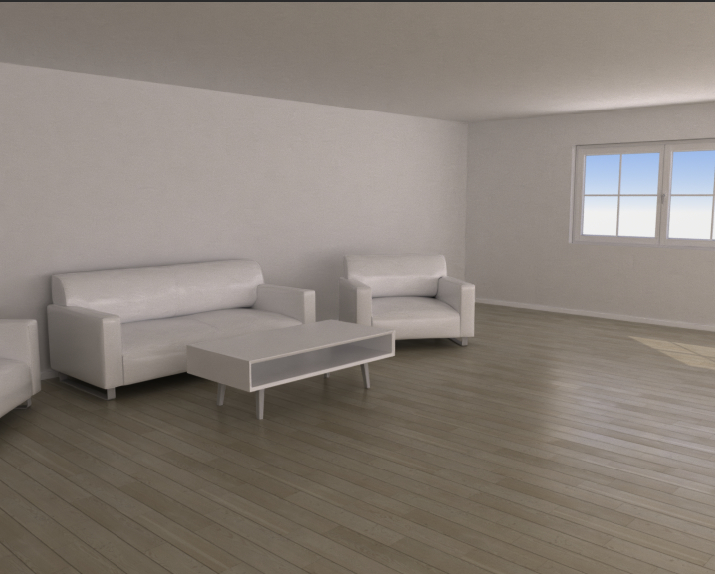

Looks like the infamous case of double EOTF (A.K.A "Gamma") in other words, the conformation from Linear open domain to sRGB (closed domain) applied twice, one from the ACES sRGB ODT and the other from C4D Picture Viewer.
Are you saving from Cinema 4D Picture Viewer?
If so, make sure it doesn't have its own "Picture Profile" (EOTF encoding) as I believe it's how they call it.
