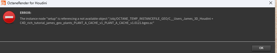

I'm running into issues using 'instacefile' to reference cached bgeo.sc files where I'm trying to instance a different frame of animation per point (achieving this by changing the path to the cached files per point).
I'm getting this issue when the IPR starts to render:
"The instance node "setup" is referencing a not available object "/obj/OCTANE_TEMP_INSTANCEFILE_GEO/....{path to bgeo.sc}"
The strange thing is that if I close this error message the render seems to work as expected, however this message pops up every frame meaning I can't really render the scene.

Ok so unfortunately it seems to have something to do with the instance motion blur as far as I know.
For now, if you disable "Enable Instance MB" (under ROPS / MotionBlur), you won't get the error.
Sorry for the inconvenience caused, it is currently being looked into - Thanks again for reporting this.
