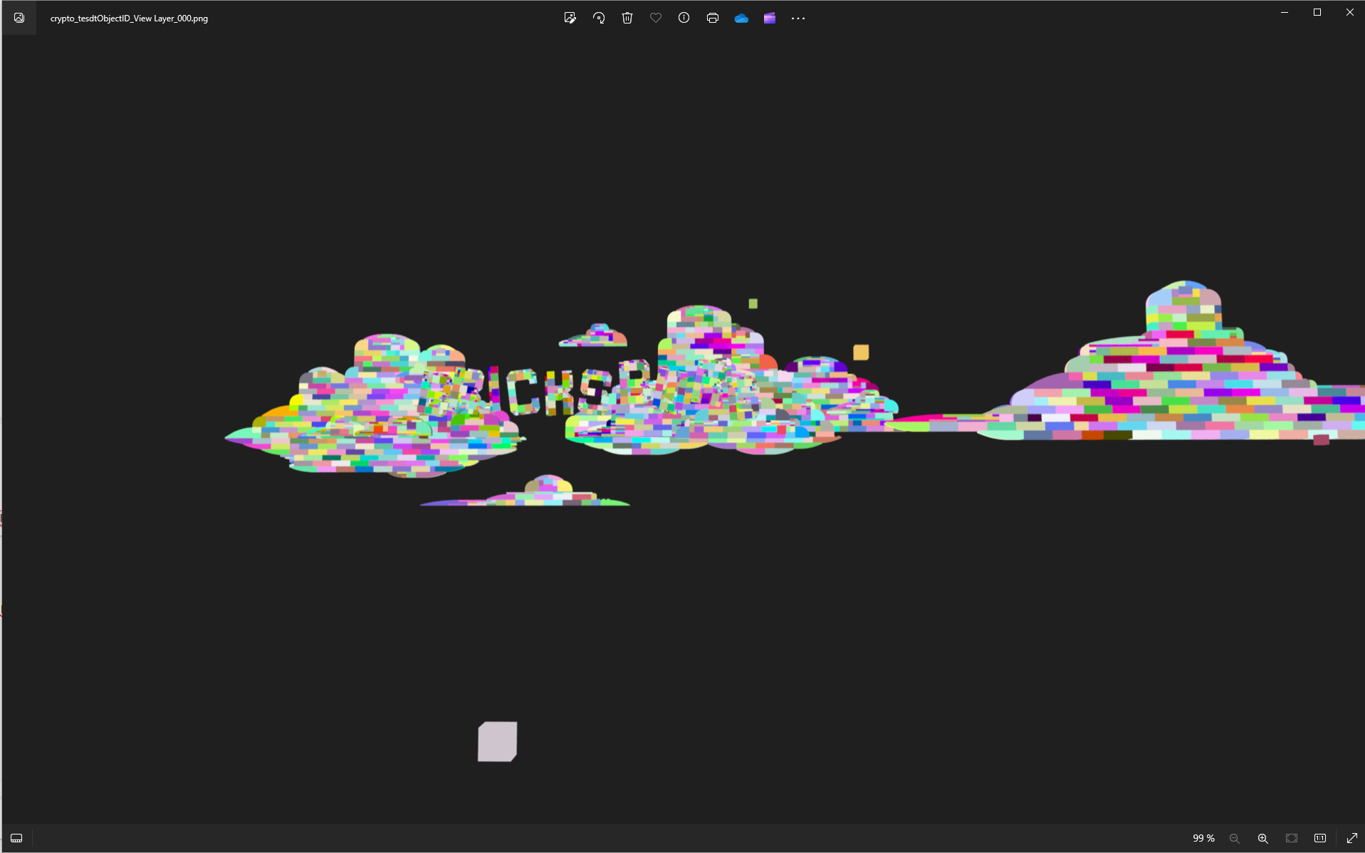

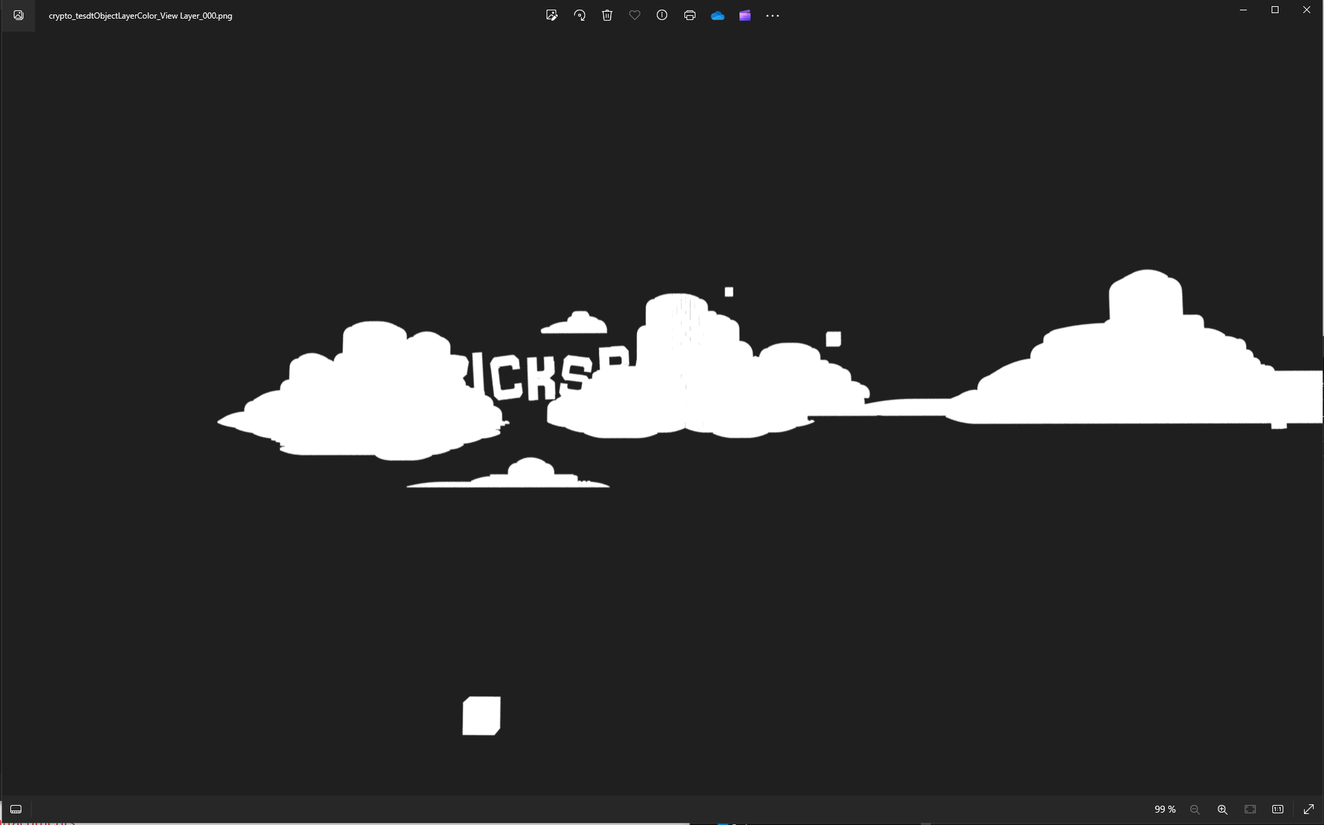

I installed the newesst version of your Octane tools but I didn´t get the "Copy Object Color from Active" runs properly. So what i Did is just select my objects and hit the buttton. My cryptomattes Layers looks still the same. The white image is the Render Layer ID Pass, the colored is the Object ID Pass.
Did I missed something?
thx alot!
Object Layer Color Pass
Object ID Pass

You need to use the "ObjLayerColor" pass in the Info section of the render passes. Or for the other option you can also use the "BakingGroupID" pass.

sry I missed the correct spelling. The white image is the Object Layer Color Pass not the Render Layer.

But isn't the black/white version above what you want?

I would like each cloud to have its own ID color. There are many small clouds in front of the large clouds that are not visible now. I can solve this problem by giving each cloud its own material ID, but ideally it would work via the object ID. It would also work via the RenderLayer ID, but the Render ID Layer Pass cannot be interpreted by the compositing software /Fusion/. This drives me nuts .....Such a simple task turns out to be super complicated ...
Andreas_Resch
Posts: 323
Joined: Sat Jul 28, 2018 6:29 am
Then just assign a different Group Layer Color to each of those cloud groups and render the Group Layer Color pass out. Doesn't that work?
