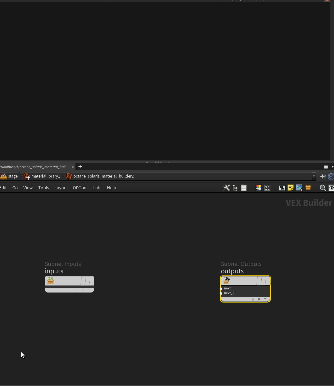

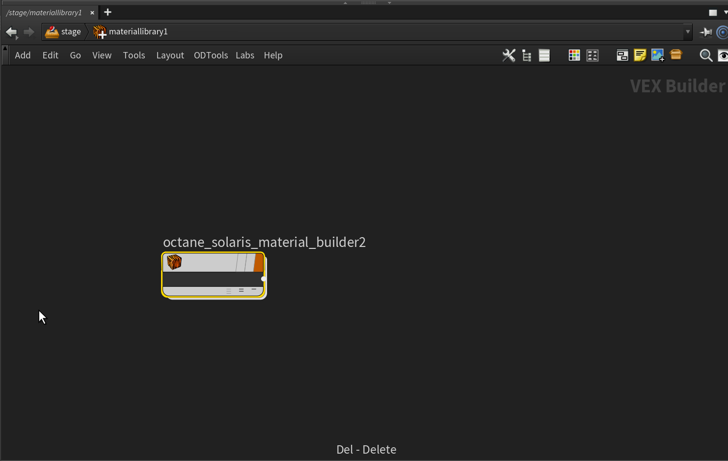

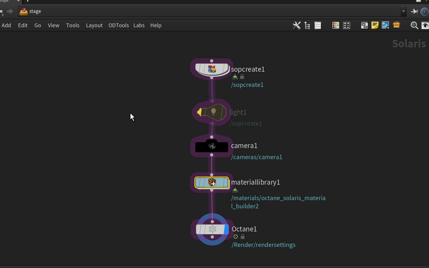

Hello, I cant get materials working properly? What am I missing?
I can get the basic setup rendering with octane so it feels like I installed it correctly.
Is the Solaris Material Builder supposed to be empty without a shader?

I installed the new version and linked to it in my octane.json file placed in packages.
Im on Houdini version 20.0.506
Carlll
Posts: 9
Joined: Tue May 23, 2023 1:57 pm
Installed the new Houdini version 20.0.590 and can confirm that fixed the material builder. So my bad for using an outdated version! All good now.
