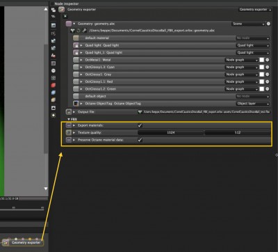

OctaneRender Standalone has an FBX exporter that can save Octane materials, if they are Octane Univeral Materials, but unfortunately, C4D doesn't consider them in import: Never tried, but Maxon has recently introduced USD support, try to export from Maya in USD, and import it in C4D 2024, maybe it could help
