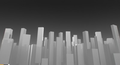

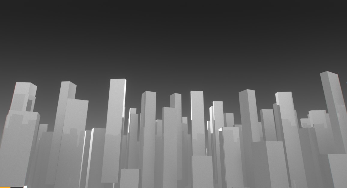

Dof looks great
The new fog looks great

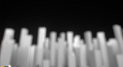

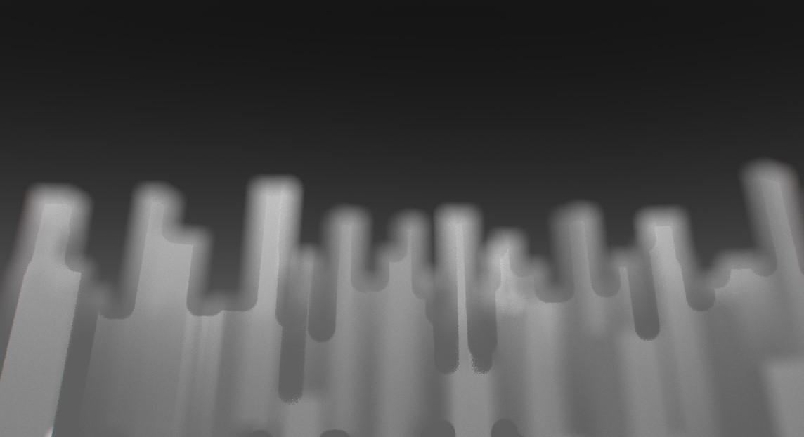

Do both at the same time and it all goes wrong, im getting thick black lines all over the place. Is there any way to combine the two without it going wrong? This is using the fog found in the camera imager > volume effects.

It is a core issue, you have the same result also Standalone.

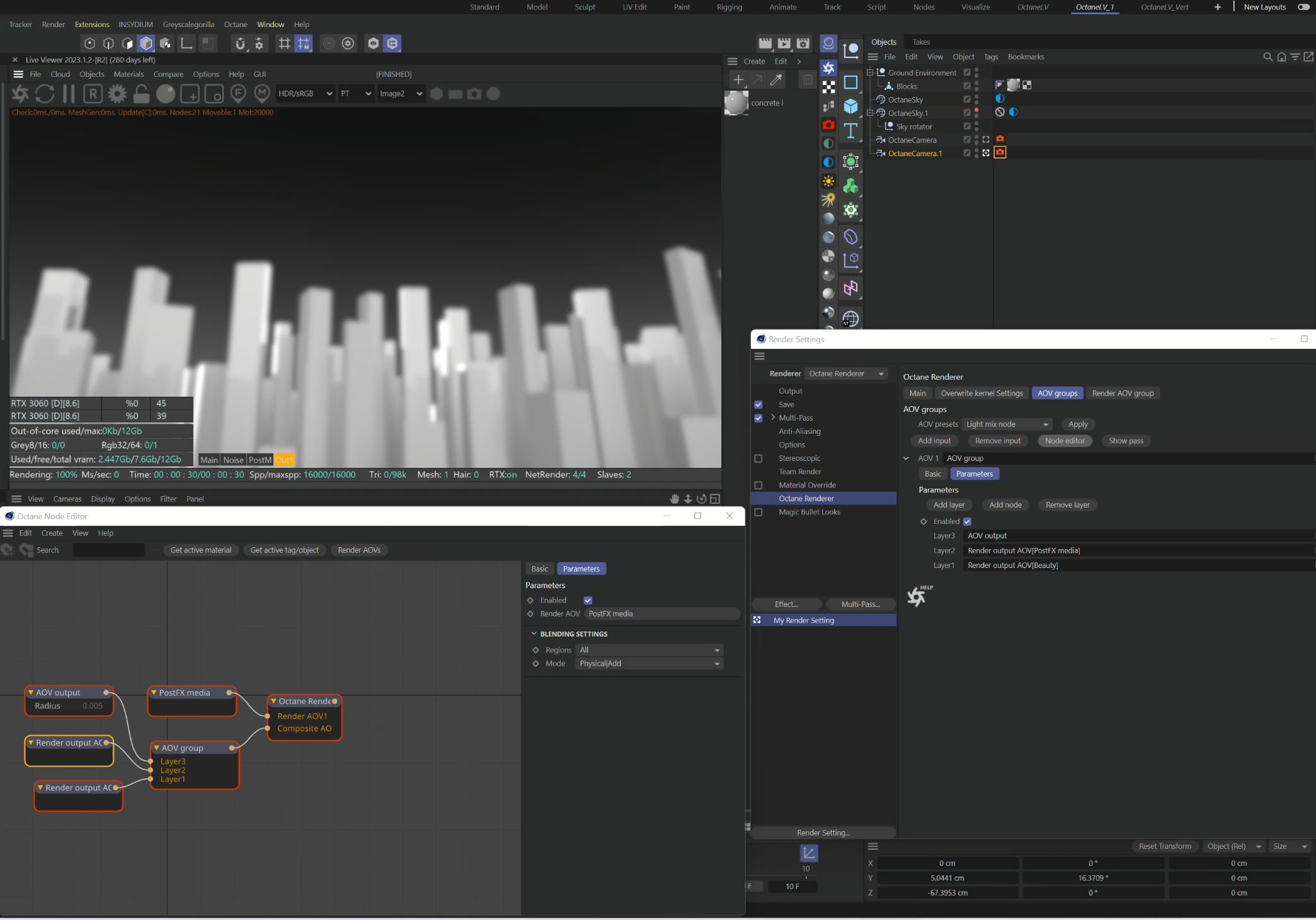

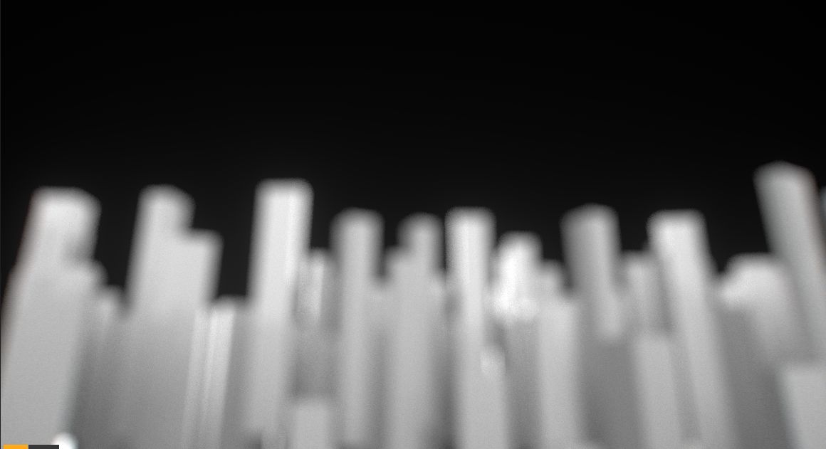

A workaround is to use the Compositor to add the Post FX Fog AOV on the Beauty, then add a Blur AOV on top:
