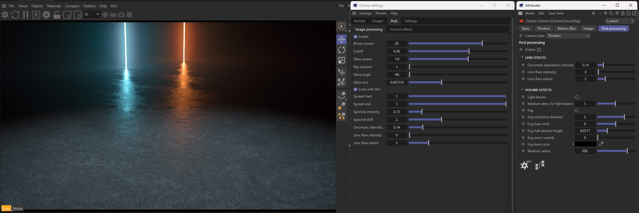

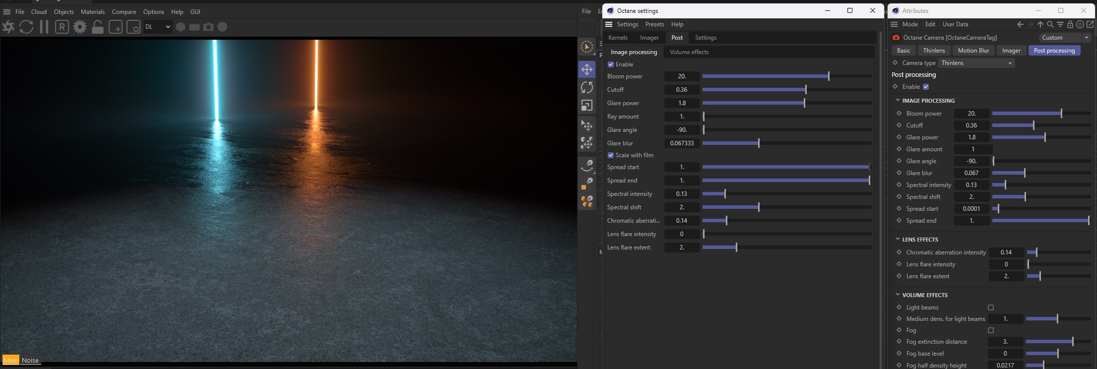

The glow effects in the octane render settings should look identical to the glow effects in the camera tag right? I cant get these to match.
Octane settings glow:
Same settings on camera:
project attached
octane 2023.1.2
c4d 2024.2.0
win 11
post effect glow different from camera glow

Scale with film makes no difference, though on a side note this setting seems to be missing from the camera glow version UI.elsksa wrote:Does the dissimilarity occur when deselecting "Scale with film" and without and any FX from the Lens Effects section?
Is the "color management" consistent and properly set?
Color management is 100% defaults
Ok, please remove the installed c4doctane version and upgrade to 2023.1.2-R2 stable:
https://render.otoy.com/customerdownloa ... R2_win.rar
Then correct the General Post Effects values, and you should have almost the same result.
There is still an issue with Spread Start value, and will be fixed in next update.
