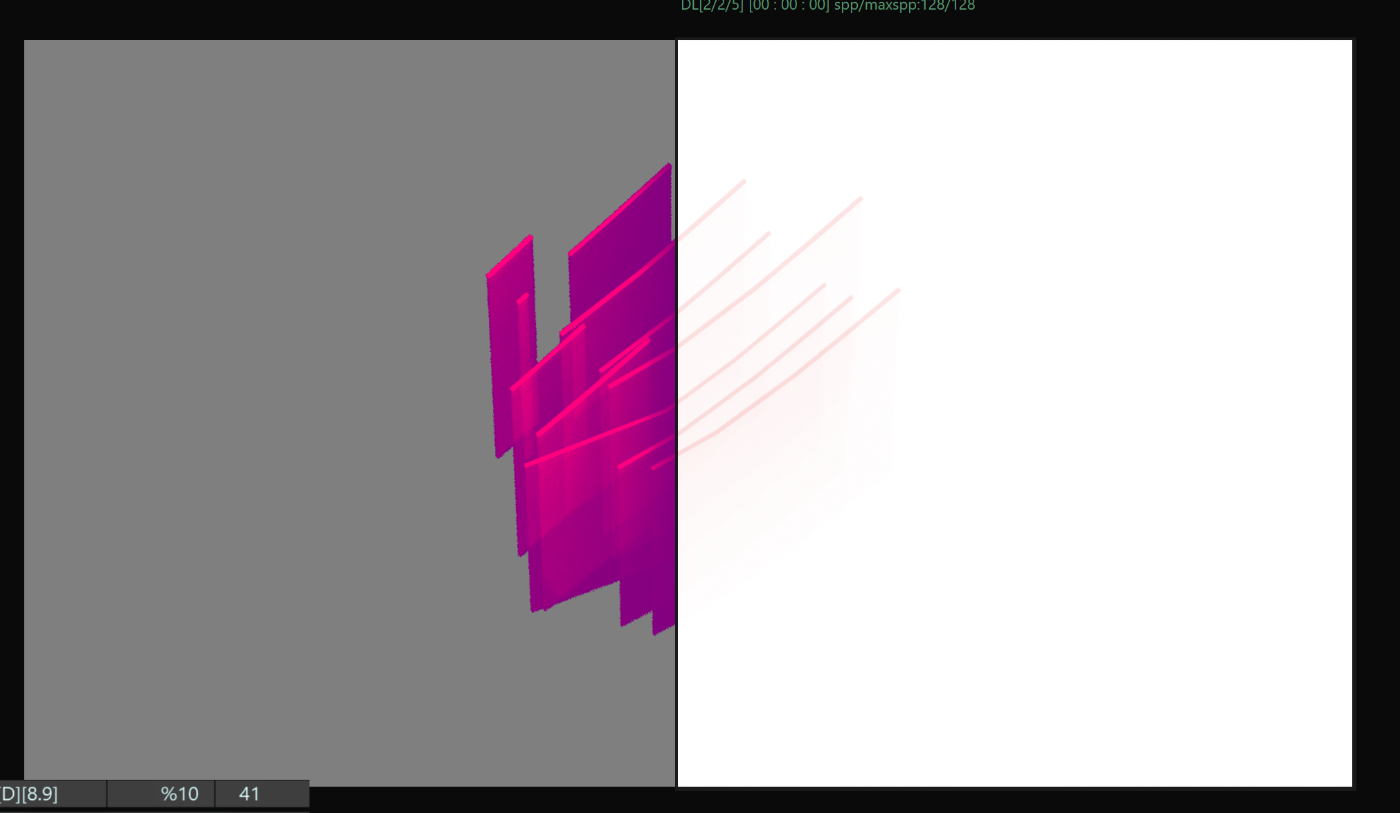

It looks like the Tracer elements are created from scratch on each frame in a new location instead of actually moving, so there isn't actually any motion vector data associated with them for motion blur to use. Take a look at them with the Info Channels>Motion Vector kernel. Each particle Trace has no motion vector data. Then try animating the position of the entire Tracer object and you'll see motion data for all its elements.
If the Trace generator object is not moving, then the individual traces it re-creates on every frame are not technically moving either.
So this seems like this is a limitation of the way the Tracer works more than of Octane itself.
Here's a split screen shot of the Info Channel Motion Vecors and your setup, but with the Tracer object animating up and down You can clearly see the motion data. With the Tracer object still, there are zero motion vectors and you get a flat gray image.

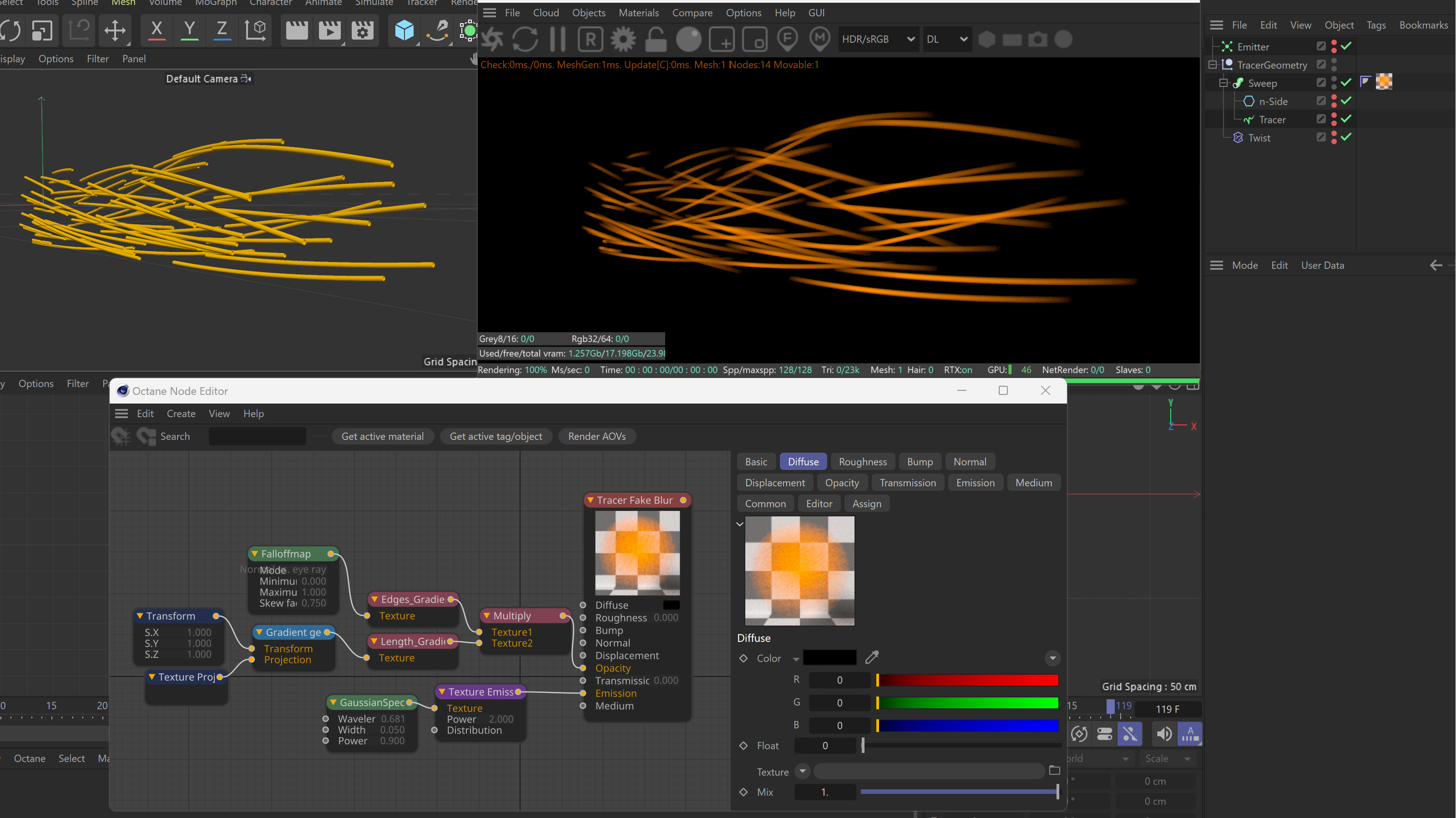

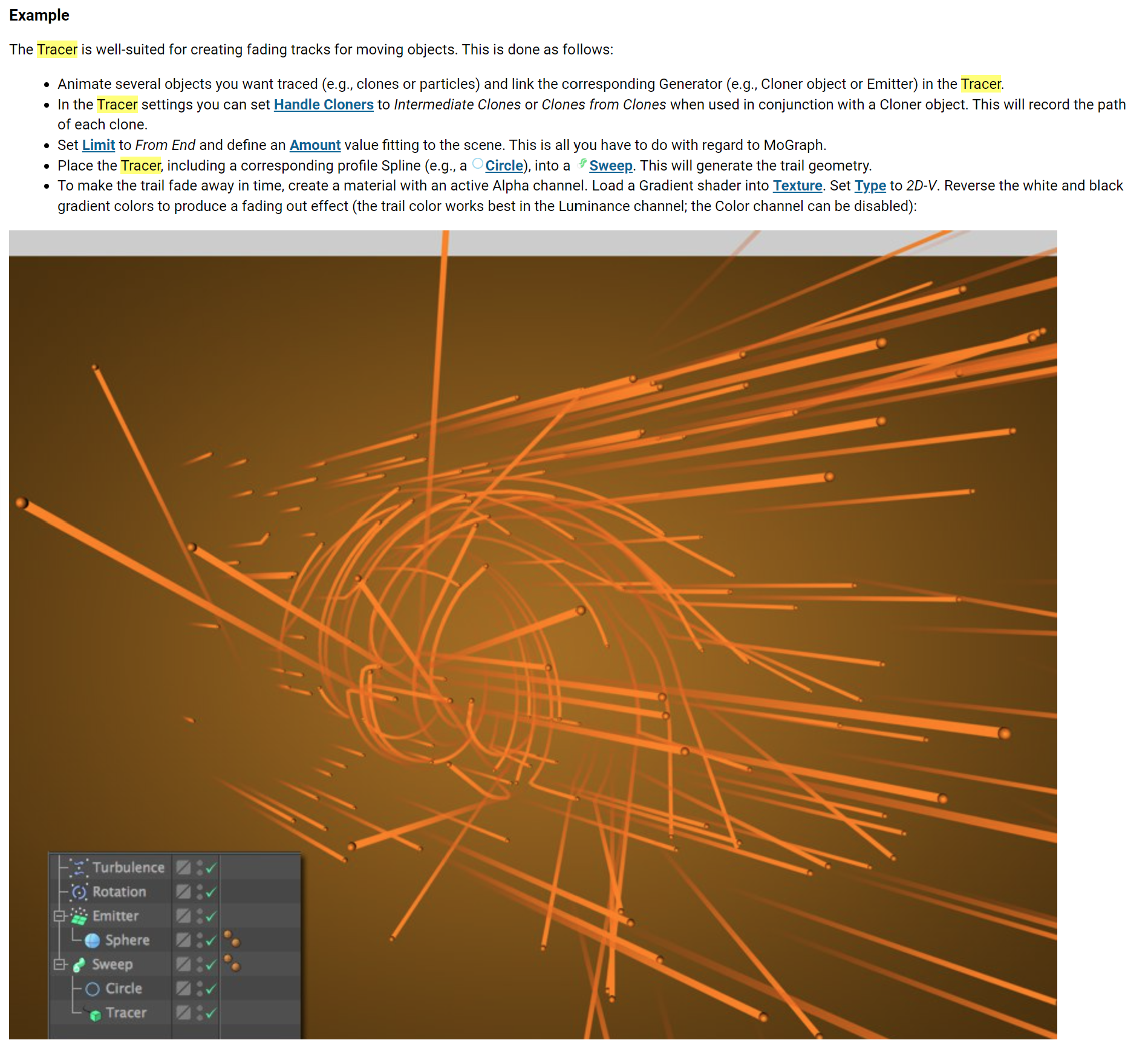

... or it just occurred to me, you can fake it with a texture, since Tracer is actually producing a spline you can sweep a profile down them and apply a ramped opacity material onto it. The C4D docs talk about this briefly under the Motion Graphics Tracer Object section.

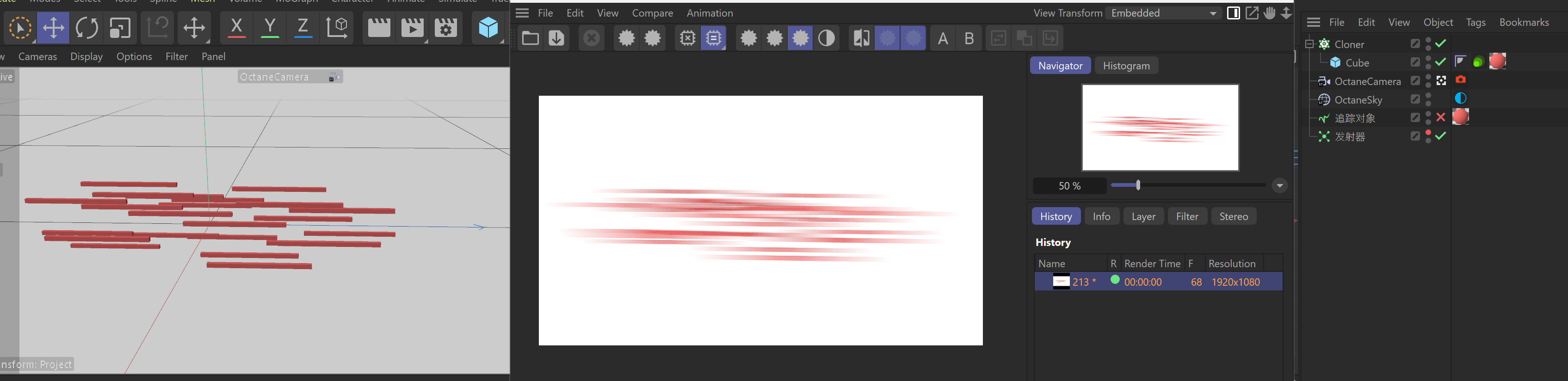

Motion blur on normal particles works fine in Octane; it's just this particular way you are creating them with the Tracer that doesn't blur. The C4D Tracer generator completely recreates elements afresh every single frame, so there is no motion in the resulting elements. In comparison, here is a shot of your scene with cubes assigned to the particles instead of a Tracer and they blur as you would expect. Be aware that the Octane Live Viewer doesn't always have all the information it needs to render proper motion blur for individual frames. To check that motion blur is behaving the way you want, it's best to render a couple frames in the Picture Viewer.

Since the C4D Tracer tool is specifically what you want, I think the option of turning the Tracer paths into geometry using Sweep and a small profile, then applying an opacity gradient texture to that Sweep geometry is your best bet; something like the attached screen grab. In this case I used luminance in a dark environment, but you could use standard diffuse color with an illuminated environment just as well. Keep both your Sweep profile sides and number of Sweep isoparm subdivisions low to prevent things from bogging down with large numbers of particles.
Good luck!
I understand what you mean, use gradient transparency to blur the surroundings to create a fake motion blur effect, thank you for your communication.
