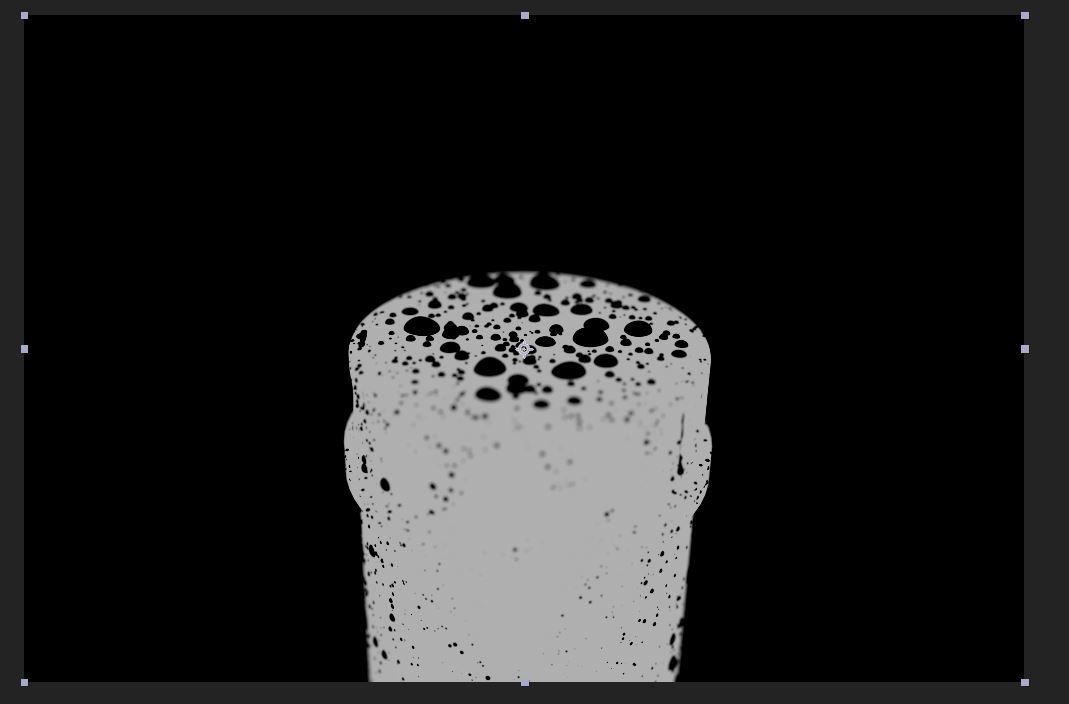

my problem is when I select a cryptomatte ID in After Effects and set the cryptomatte output to "matte only" the selected ID gets grey but not white.

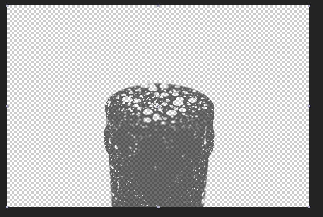

When I change the output to "matted RGBA" my selected ID gets half transparent.
matted RGBA
matted RGBA

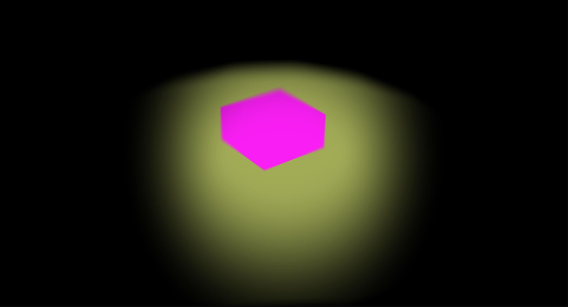

That's how it looks with a regular aperture shape from octane:

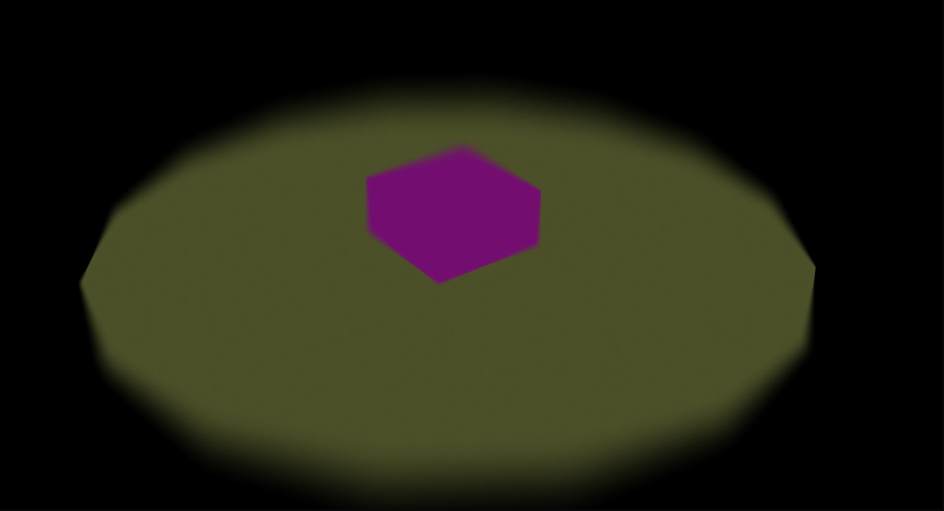

When adjusting the optical vignetting distance, I've observed that the vignetting effect is also affecting the cryptomatte:
I guess it is the excact same problem. Is this a bug or limitation of Octane :?:

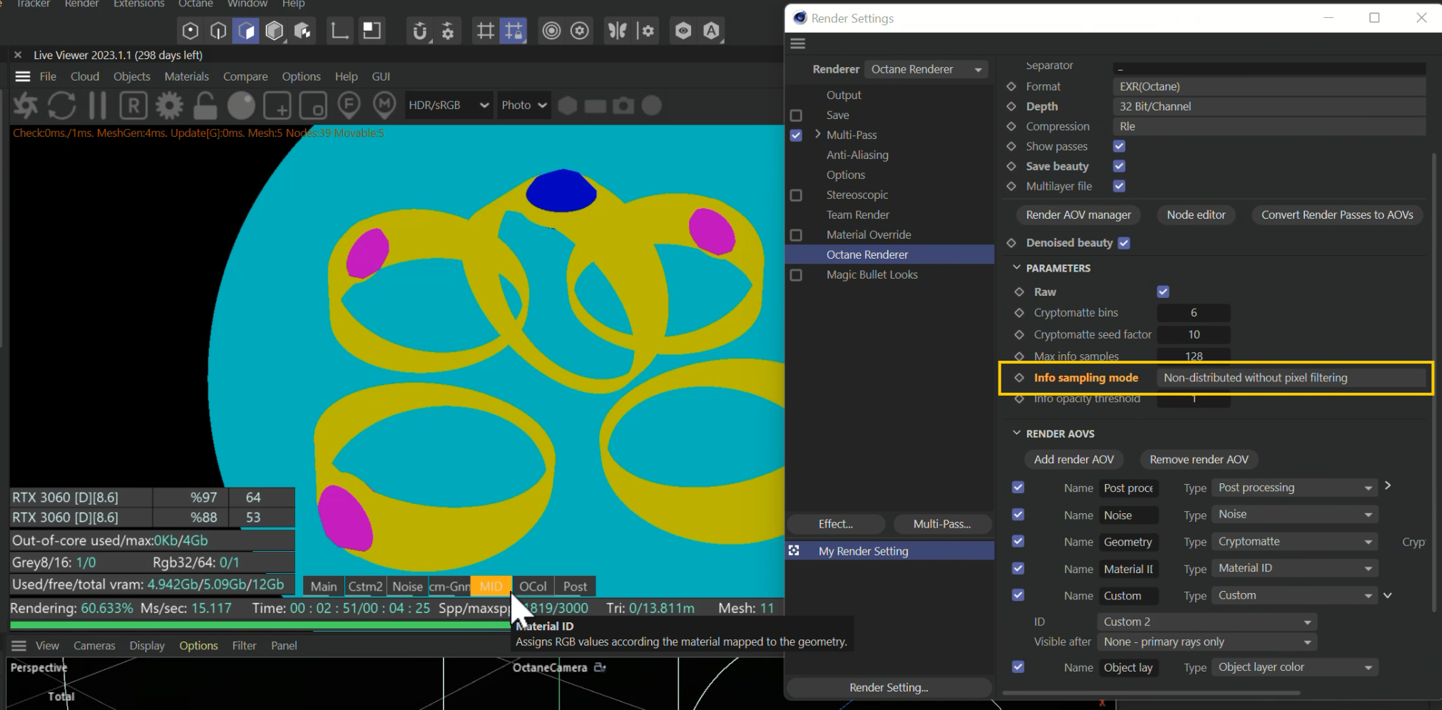

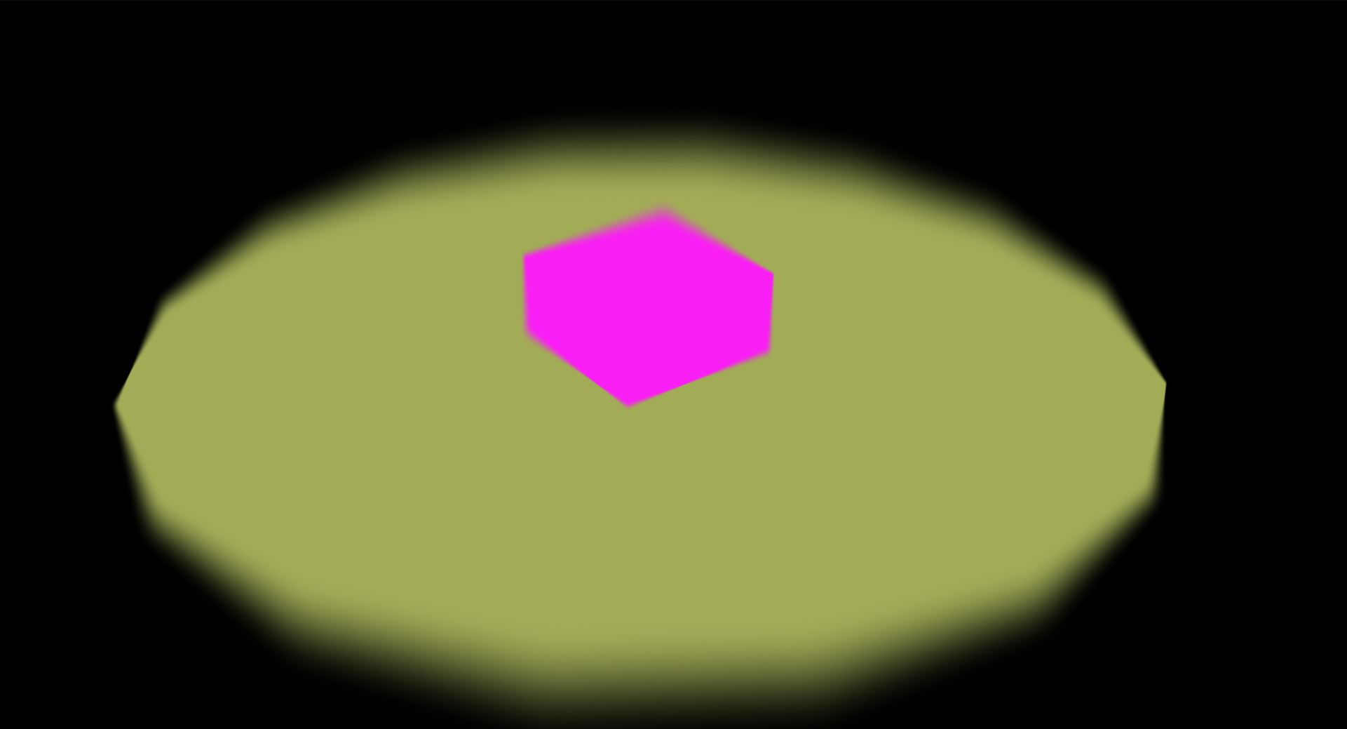

to remove DOF, you need to go to Render AOV gropu tab and change the "Info sampling mode" to "Non-distributed without pixel filtering", but it works only for Octane Info AOVs, here is with Mat ID, but as you can see the Universal Optical Vignetting is not removed:

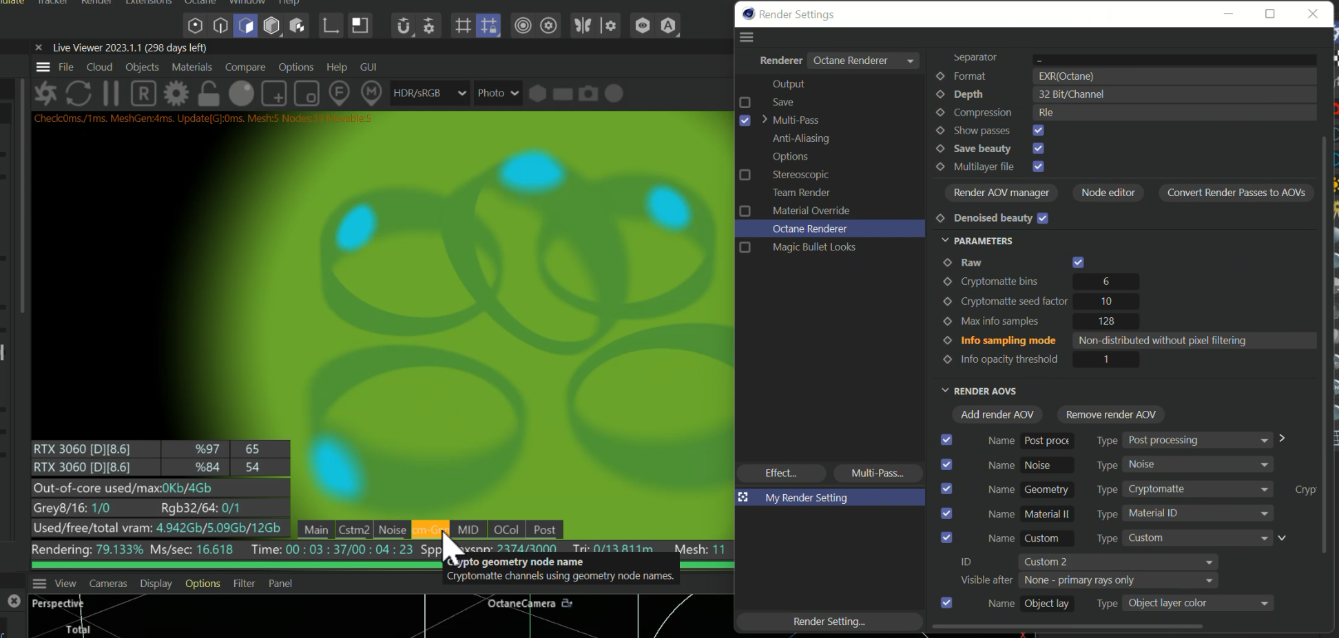

And it doesn't work with Cryptomatte AOVs:
So, to obtain correct Cryptomatte AOVs, you need to re render the scene by switching the camera from Universal to ThinLens, set the Aperture to zero, and the Max Sampling to 1 in Kernel panel.
