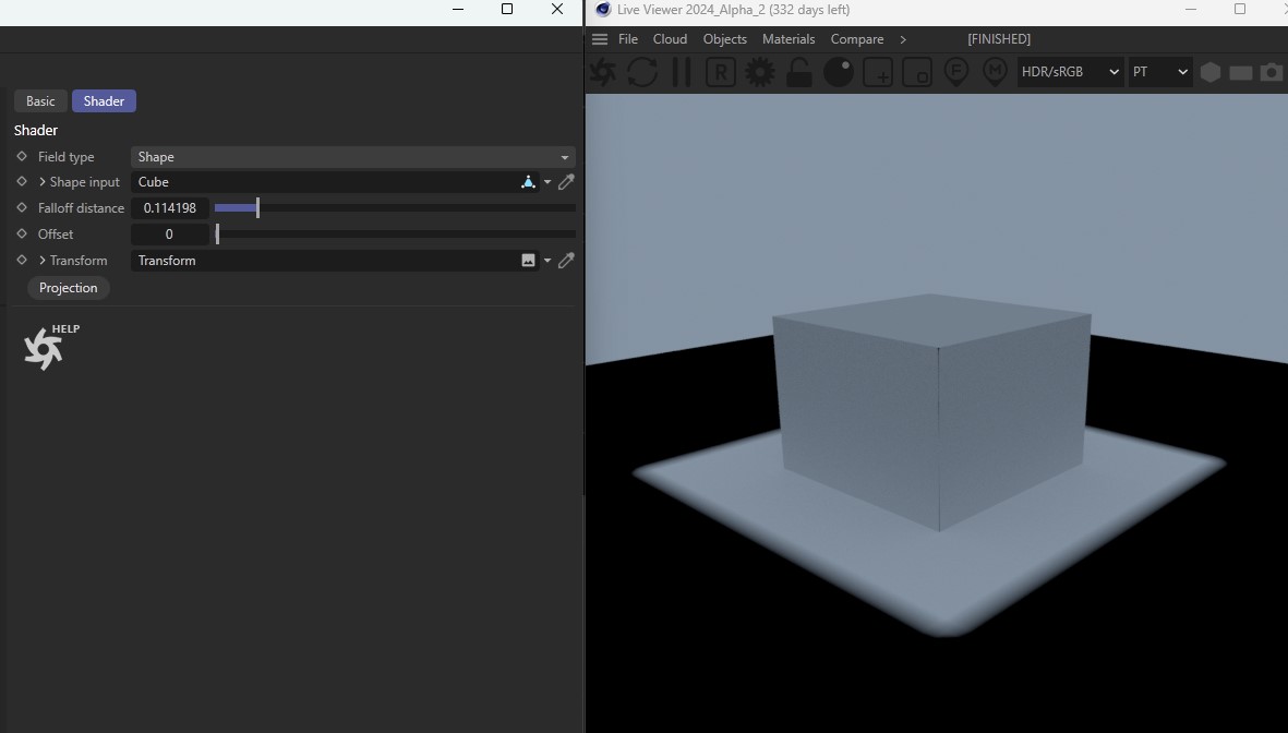

Can you check how Mesh to SDF with Field Shape texture works on this alpha ? I don't know how to setup nodes in Standalone but in C4D version it works extremely slow compared to previous versions and it is very unstable - it often freeze during rendering. It doesn't show anything on start until something is not changed in field texture.
Simple setup like this :
Architectural Visualizations http://www.archviz-4d.studio

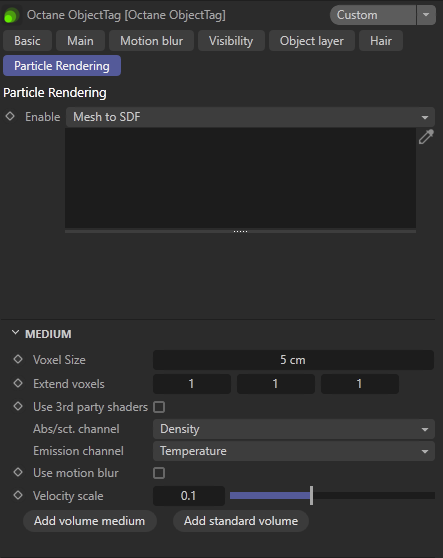

SSmolak wrote:Can you check how Mesh to SDF with Field Shape texture works on this alpha ? I don't know how to setup nodes in Standalone but in C4D version it works extremely slow compared to previous versions and it is very unstable - it often freeze during rendering. It doesn't show anything on start until something is not changed in field texture.
Please share the options you use for the Mesh to SDF (voxel size and border padding). How many voxels are generated? Does lowering the number of generated voxels changes anything?

jobigoud wrote: Please share the options you use for the Mesh to SDF (voxel size and border padding). How many voxels are generated? Does lowering the number of generated voxels changes anything?
I see only these options here. Changing do nothing except more or less accurate SDF shape.
