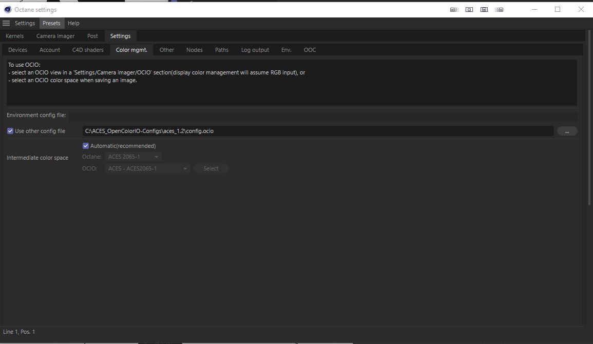

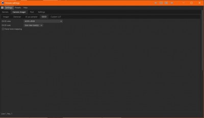

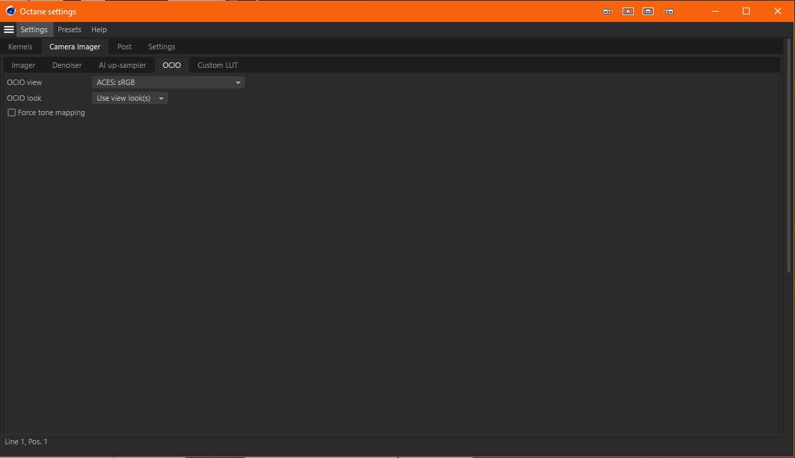

Maxter
Posts: 21
Joined: Mon Sep 09, 2019 7:10 pm
Location: Germany
I heard form this workflow but mine worked with no problems.
I added some screenshots how I setted it up.
Once I removed the OCIO and all links to it, I saved it and restarted C4D. After that I imported the OCIO and
now it works again... I really don't know what the problem was
