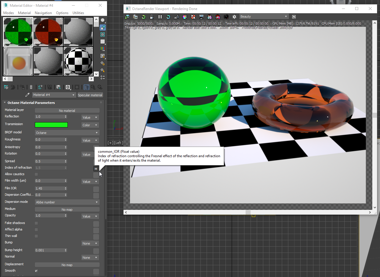

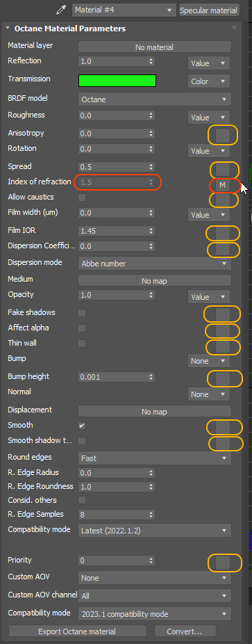

In the material editor, a square button is available on the right side of compatible parameters. Click or drag to set a Value texmap.
As with other 3dsMax texture buttons, use the context menu (right click) to Clear, Copy, etc..

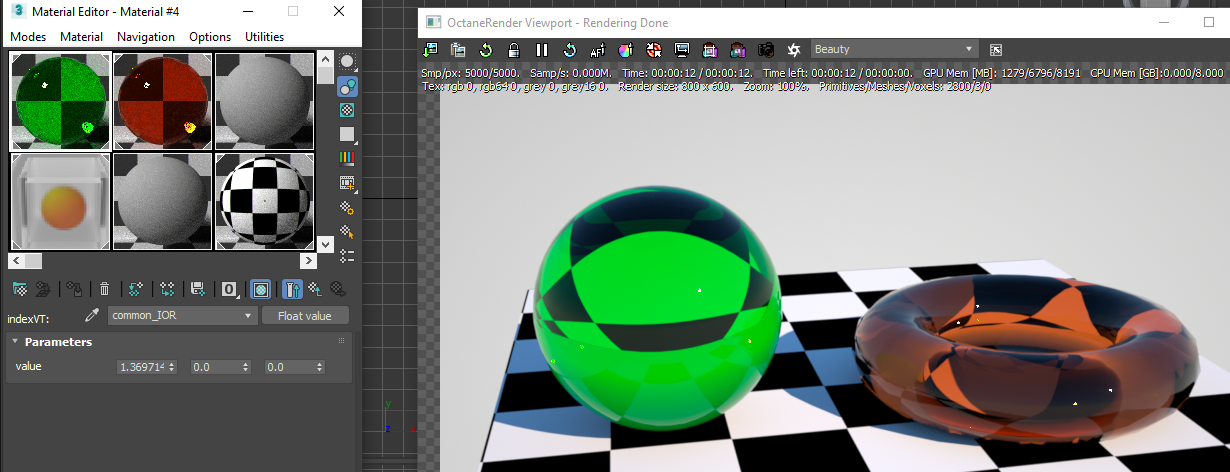

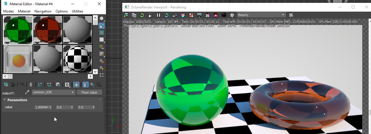

For example, the 'Index of refraction' of several Specular materials can be set as a common Float value texture, as in this sample:

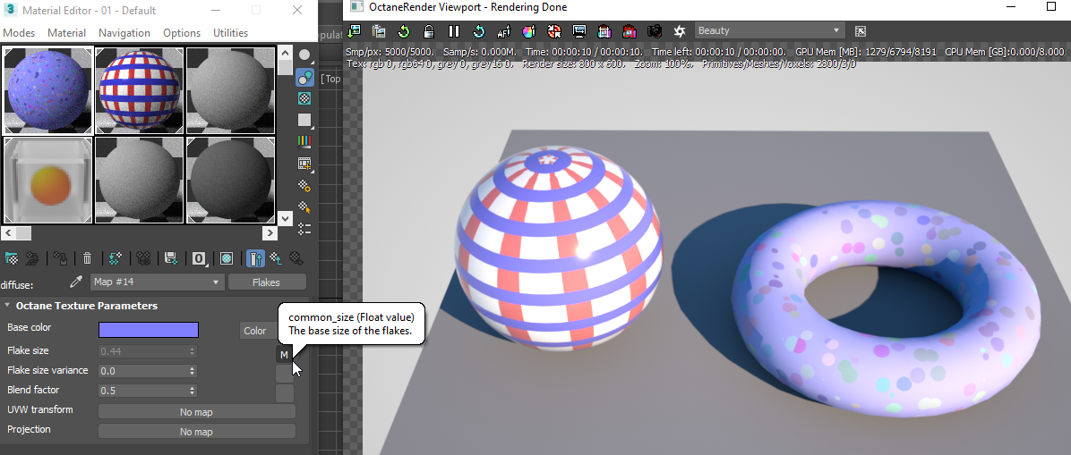

Another example: the Flake size of a Flake texture can be set as a Float value texture, and the Thickness 1 of a Stripes texture can be set to the same Float value texture.
Changing the value of the Float value texture will affect both the Flake and the Stripes texture.
