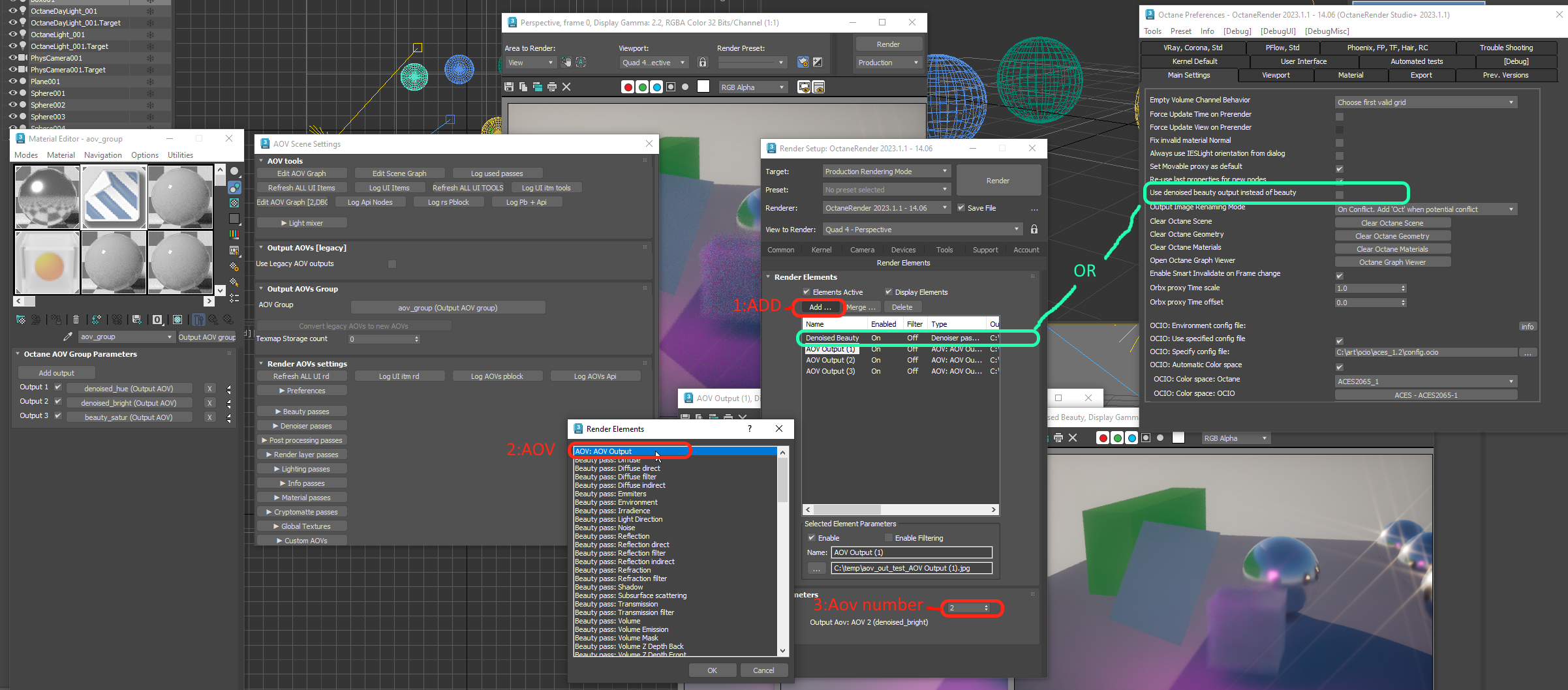

For the 'Use denoised beauty output instead of beauty', that's is the Main settings tab of the Octane Preferences.
When enabled, you don't need to add the 'Denoised beauty' pass in the render elements. (the rendered and saved image will be the denoised one)
(see the green anotations here:)
There is also, in red, the way to add AOVs as render elements.
(it's useful to set a good name to the 'aov' texmap, so you can check in this Render element dialog)

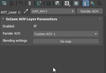

For the Custom AOV, it's the same as other 'render AOV' :
Set a Render AOV texmap in the first layer of a output AOV, and in the drop down menu where you select the 'pass' / 'render aov', there are all the 20 Custom AOV.

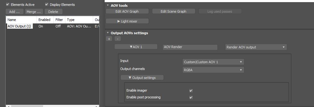

Unfortnately i am still on Version 2021 (because newer Versions produce a different Output on an older Project). So here are no AOV Group Settings (yet?). Do you know how to set this up in older Versions of Octane? I tried to set it up under "Output AOVs settings" and add "AOV Output" to the Render Elements, which unfortunately results in a completely black render pass.

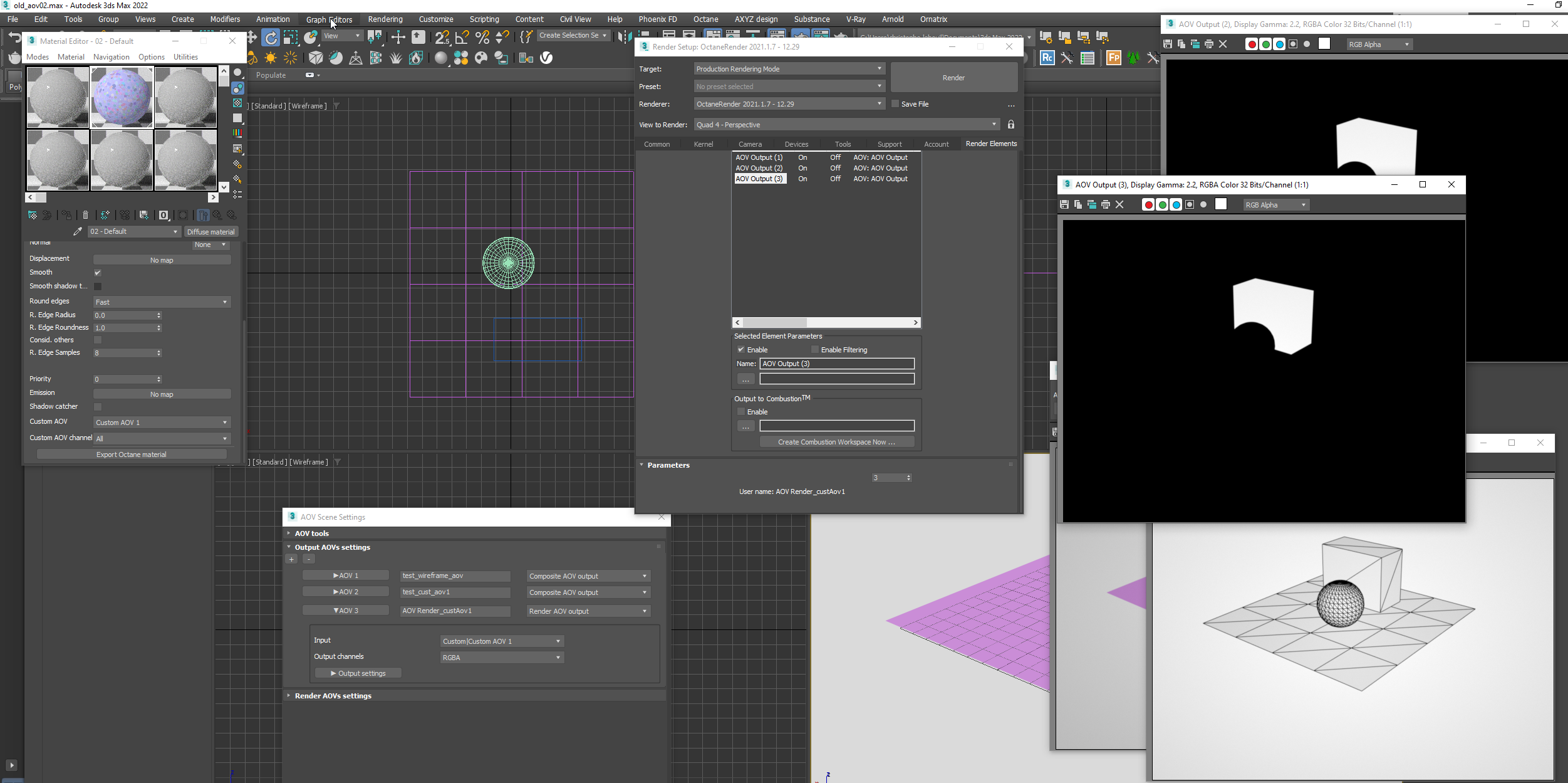

But I tested with 2021.1.7 - 12.29, it seems to work fine:
custom_aov_rend_elem_old_aov02_mx19.zip
(54.07 KiB) Downloaded 151 times
The box material is set to generate Custom AOV 1, and the Output AOV3 set as a Render AOV output, with the 'Input' set as Custom AOV 1, is like in your screenshot.
When set as Render element, the AOV Output (3) renders fine. (same as when rendering with the Octane Viewport).
