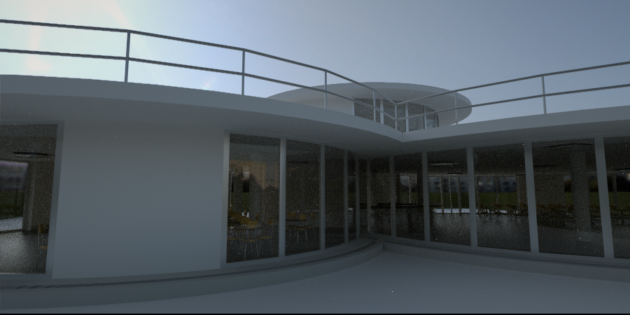

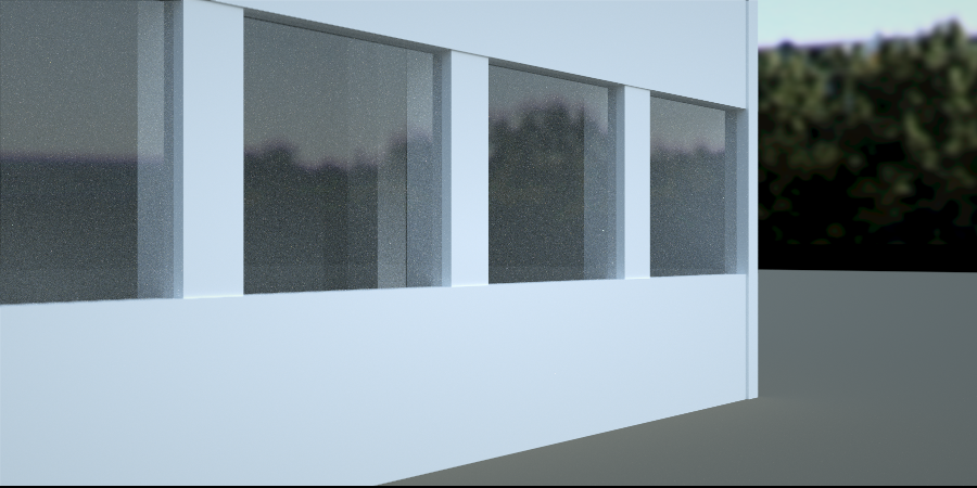

I did few tests with specular material as windowpane.
The generation of pixels behind a glass in interior is slowing down with time and the noise is not improving with time. Everything is rendered smoothly, except interior behind a glass. After 3 hours of redndering, the noise is still significant (two windowpanes 3,5h and 1 windowpane is faster bat not without noise). Do you have some tips, how to improve rendering scenes with glass windows?
That's because there's no MLT in Octane currently
You are basically lighting the inside with caustics
That's why its so slow
Wait for MLT and light portals and all will be OK both outside and inside
