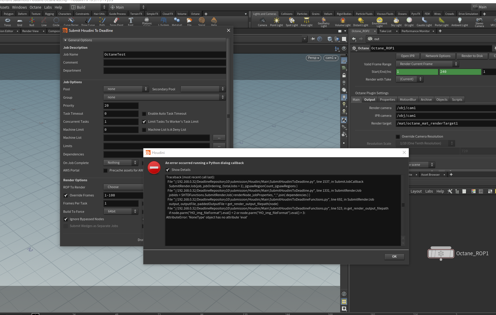

Hello,
I seem to not be able to submit to Deadline since upgrading from the 2023 Beta. It's weird but there's language in the Python error which may be something to do with the Octane ROP; any changes that have happened in there. I recall a change to the file formats happening but not sure how this could affect the Deadline submitter. Presently hacking other submitted jobs to redirect to HIPs i need rendered.
Tested even on a new, blank, sphere test scene. Pressed Octane, Render Target, Made a camera, made a sphere, submit to Deadline.
Houdini 19.5.773
Traceback (most recent call last):
File "//192.168.0.32/DeadlineRepository10\submission/Houdini/Main\SubmitHoudiniToDeadline.py", line 1537, in SubmitJobCallback
SubmitRenderJob(job, jobOrdering, (totalJobs > 1), jigsawRegionCount, jigsawRegions )
File "//192.168.0.32/DeadlineRepository10\submission/Houdini/Main\SubmitHoudiniToDeadline.py", line 1331, in SubmitRenderJob
jobIds = SHTDFunctions.SubmitRenderJob( renderNode, jobProperties, ",".join( dependencies ) )
File "//192.168.0.32/DeadlineRepository10\submission/Houdini/Main\SubmitHoudiniToDeadlineFunctions.py", line 692, in SubmitRenderJob
output, outputFile, paddedOutputFile = get_render_output_filepath(node)
File "//192.168.0.32/DeadlineRepository10\submission/Houdini/Main\SubmitHoudiniToDeadlineFunctions.py", line 523, in get_render_output_filepath
if node.parm("HO_img_fileFormat").eval() < 2 or node.parm("HO_img_fileFormat").eval() > 3:
AttributeError: 'NoneType' object has no attribute 'eval'
