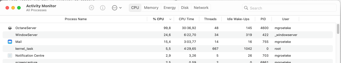

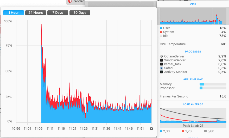

After installing the current Octane server for Blender, I can see it will use 10% of my CPU power permanently, even when not rendering or even using Blender. Also, I cannot find any way to quit the server from the app, as it is only visible as process in application monitor. I can only "kill" its activity from there.
See attached screenshot.
MacOS 14.1 on MacBook Pro M1 MAX here.
OctaneRender 28.5 server issue

It's about the same on my Windows 10 machine. The 28.5 server app constantly uses between 7% and 8% of CPU load even when Blender isn't opened at all. I compared it to V27.16 and that one uses 0%. Definitely in need of being checked.
