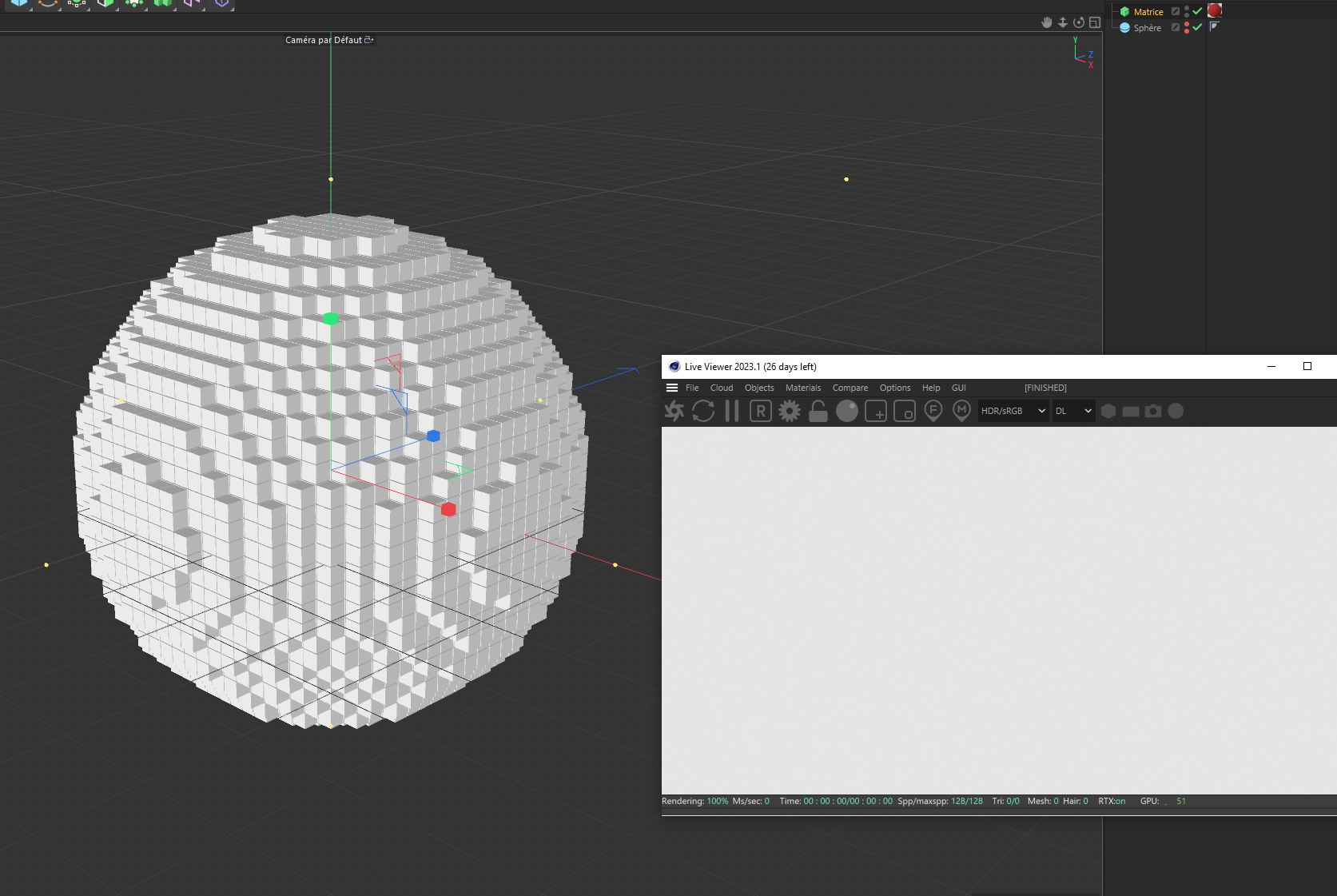

I'm trying to render a matrix object. I try many things, but I can't make it render inside octane.
Do you have any idea how I could achieve it?
I added a screenshot and the scene attached.
Thanks for the help :)

Czidler wrote:Hi,
link it to cloner and use multi-instance or render-instance mode
