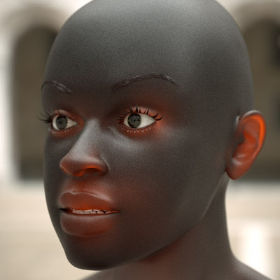

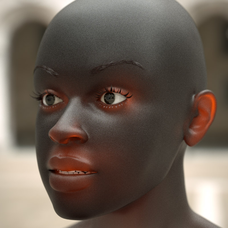

Now that we' ve got all these nice absorbtion parameters to play with I tried to create the SSS effect by creating a mix node that contains a glossy and specular material (with absorbtion).
It is not a 100 percent correct SSS effect but at least it is half way done.
I really hope that real SSS will come soon but until that day we have to cheat and play around with the sliders we have got.
Any ideas for improvement welcome.
Thank you.

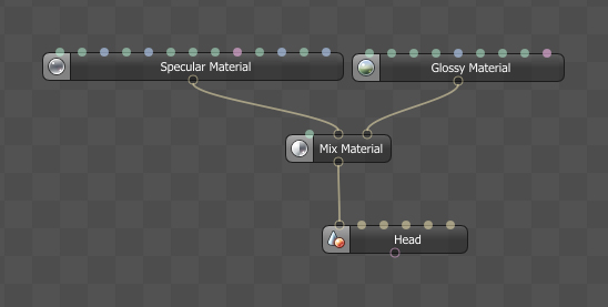

... and the node mix...

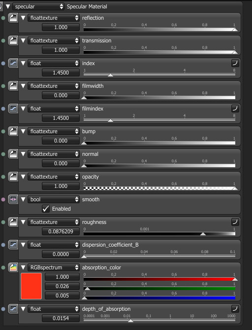

Here are the magic settings for the specular node. The other is a simple glossy with little roughness and specular, nothing special.
Hope that helps :)

What's the mix set to? just .5? are you doing anything special there?
Thanks :)

I thinkthe mix value is around 0.5. Nothing special.

One thing to note is that the opacity of the specular has to be 1 (like you see in the settings).

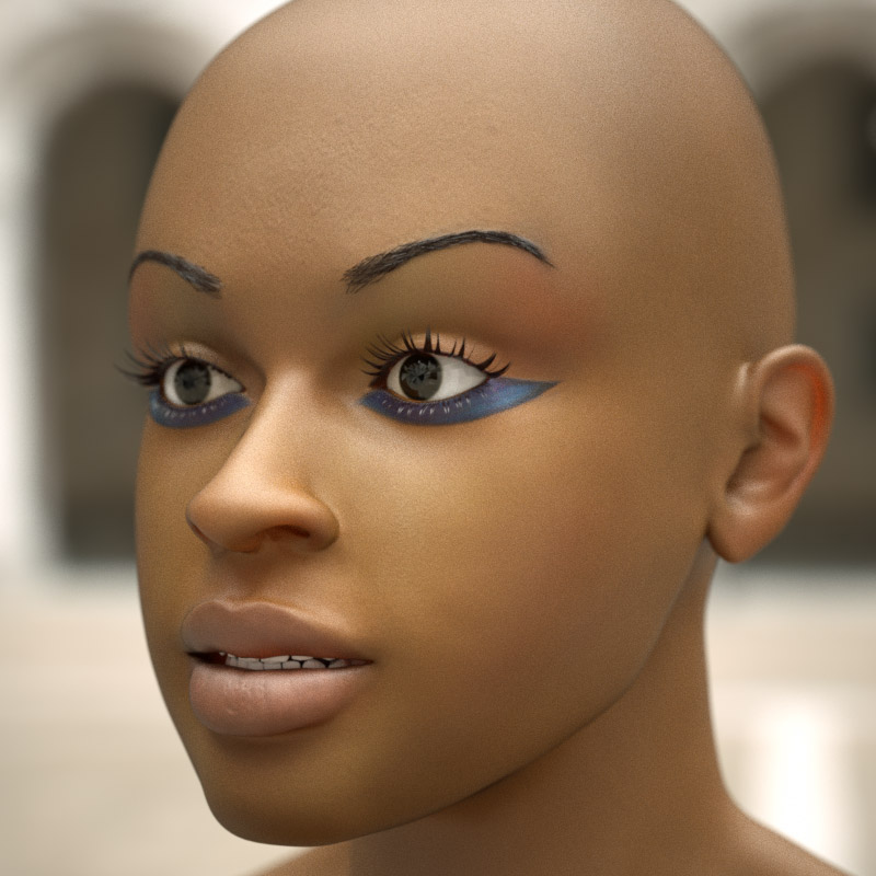

Here is a quick example with spec map used for depth of absorbtion. Raw render no postwork yet.
Test of specmap as depth of absorption controller
