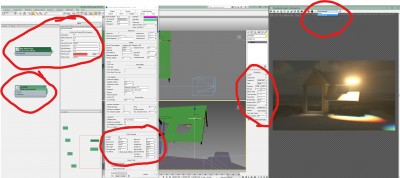

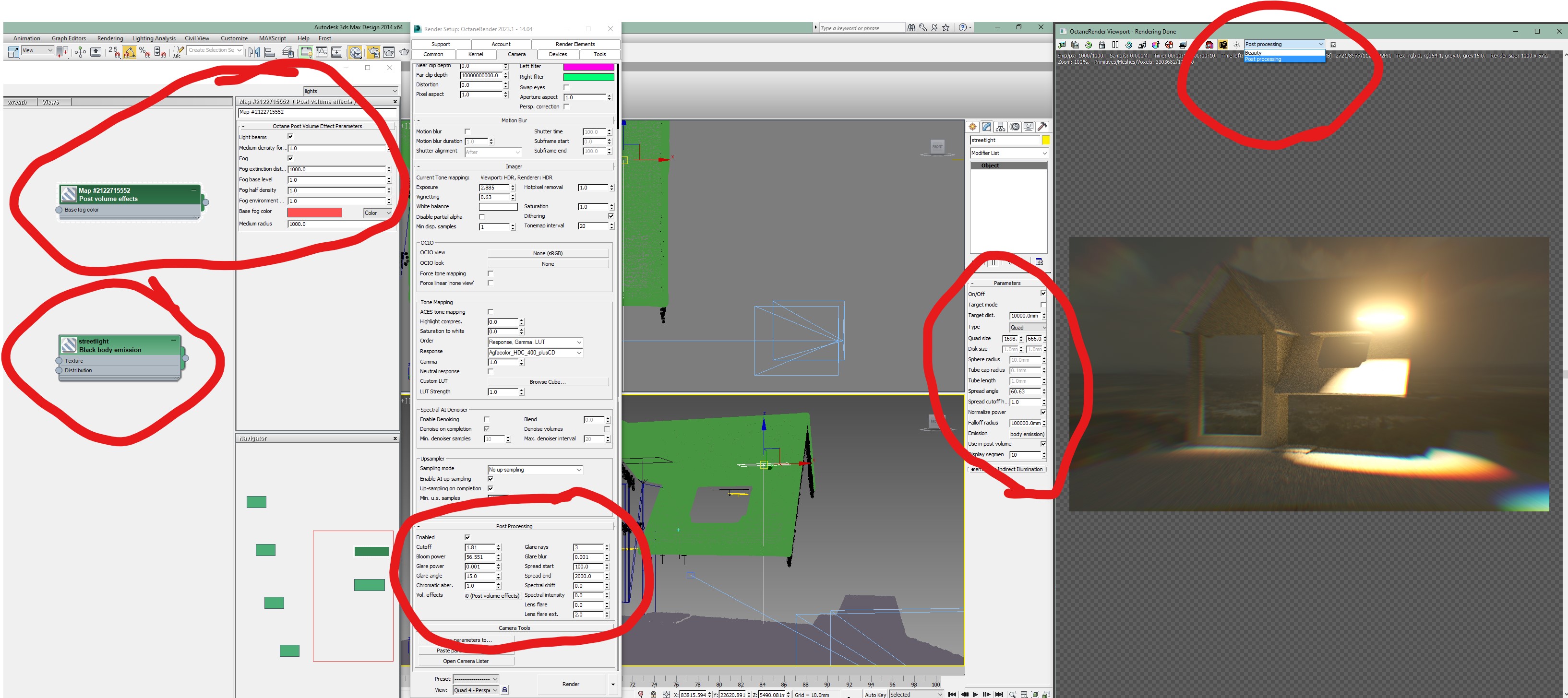

Any info anywhere for max users on how to use the post processing? Here's a youtube vid for the lucky c4d users but I can't make it work with max.
https://www.youtube.com/watch?v=9R6-FTFSo1o
Just seems like there are too many places to make changes with no instructions...
Rik
Posts: 423
Joined: Wed Jul 28, 2010 8:57 pm
In post processing, Cutoff no longer appears to work. Actually this works with a camera view but not with a perspective view...
Does Chromatic aberration need to be minimum of 0.01? Everything goes black if you set it to 0

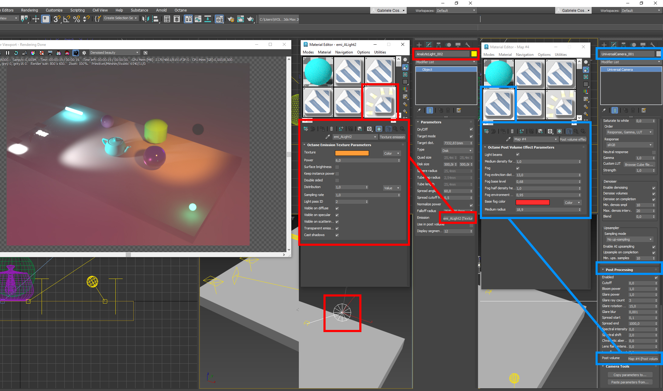

paride4331
Posts: 3989
Hi Rik,
I hope it helps.
Regards
Paride

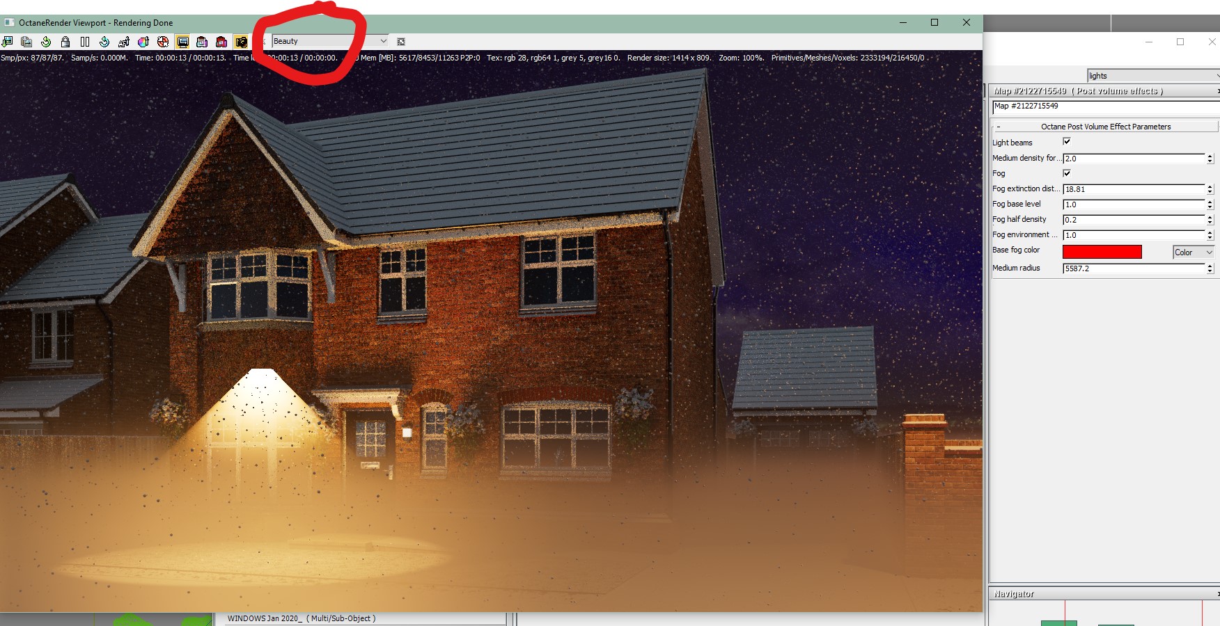

OK, I've finally managed to get fog and light rays working - turns out that these post VOLUME effects only show up in the beauty pass.
But - the post PROCESSING effects (bloom, lens flare etc) only show up in the post PROCESSING pass.
How do I see them both at the same time please?

paride4331
Posts: 3989
Hi Rik,
I can't reproduce this issue.
Everything seems to be working well.
Regards
Paride

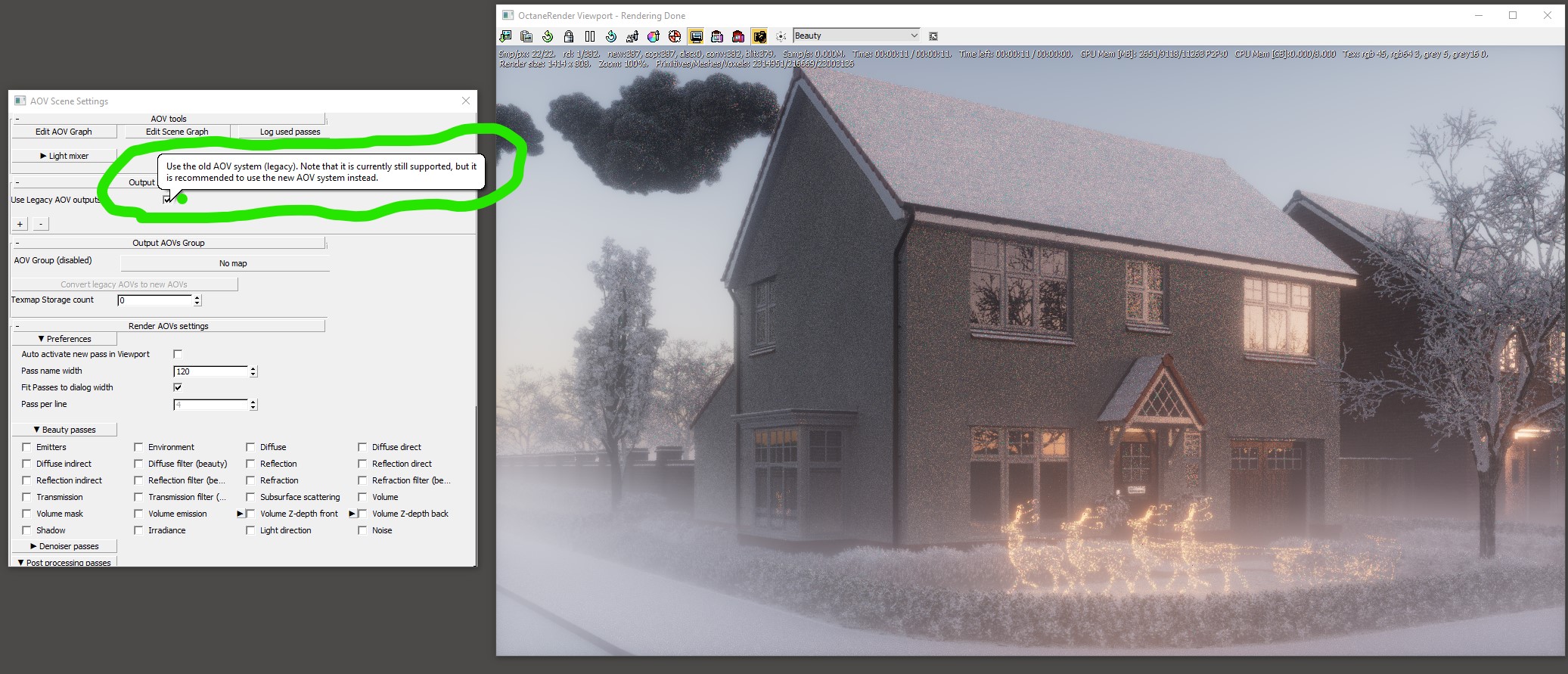

The only way I can get the blur from post processing in the camera menu and fog post volume effect to both show up at once was by ticking the 'use legacy output AOVs' in the AOV settings. Is this normal?
Bit concerned about the tooltip saying it's currently still supported. Does this mean that it soon won't be?
