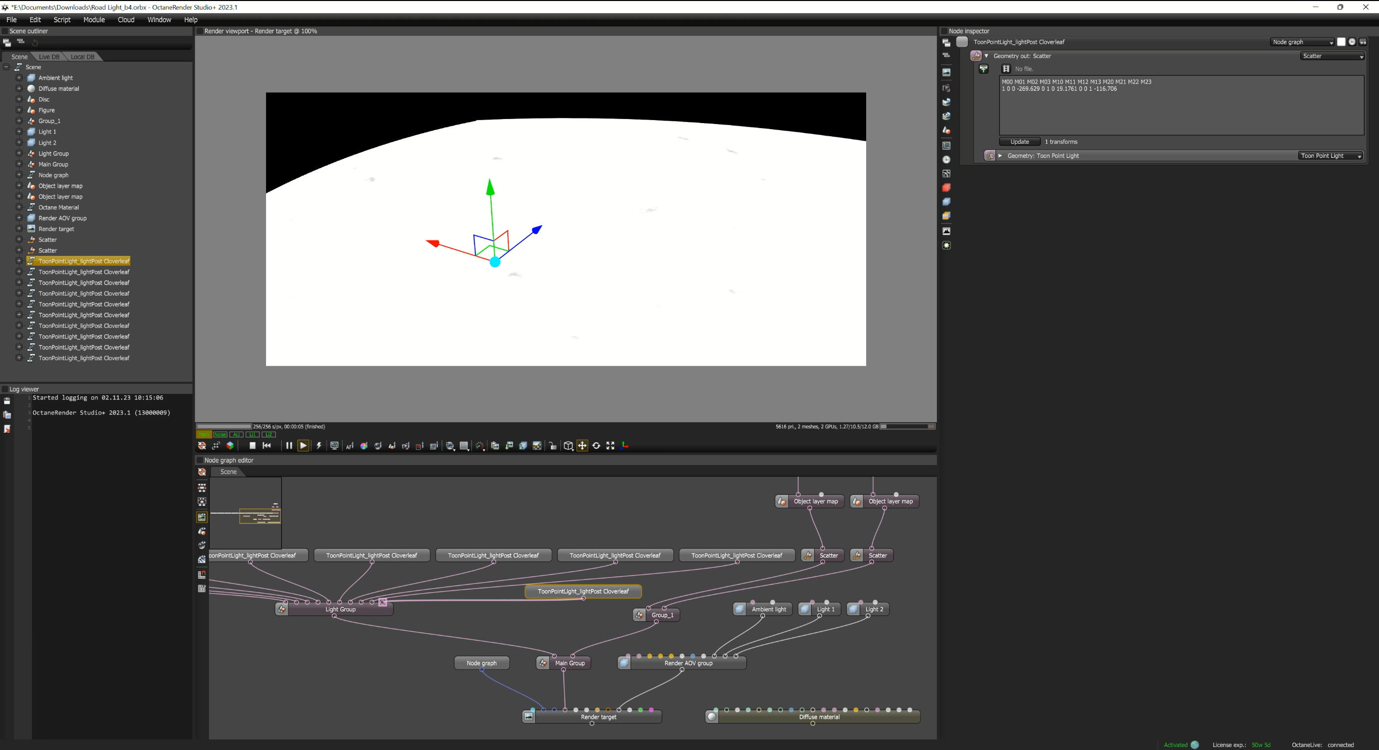

I'm having a hard time figuring out this.
I'm creating a scene with toon shaders and toon lights.
The problem is that if I have 8 toon lights, all correct, but as soon as I incorporate another one, the scene broke.
Is there a way to put more than 8 ToonPointLights? Or are we talking about software limitation?
Here is the file:
https://easyupload.io/gqxdki
I have the version 2022.1.1[R4]
Thank you so much.
Posts: 10589
confirmed, it is a Toon Light limitation.
If you add a ninth Toon Light in Standalone 2023.1 it does the same:
