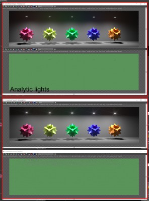

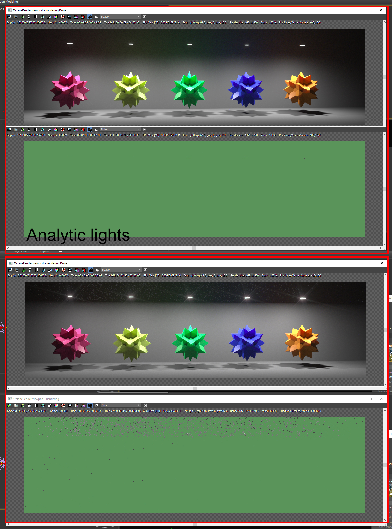

Considering the characteristics of the analytic lights (which I'll describe at the bottom), I also achieve greater cleanliness in PT (Path Tracing). You can see it by comparing the noise layer, with a saving, in this case, of two minutes, for example.
