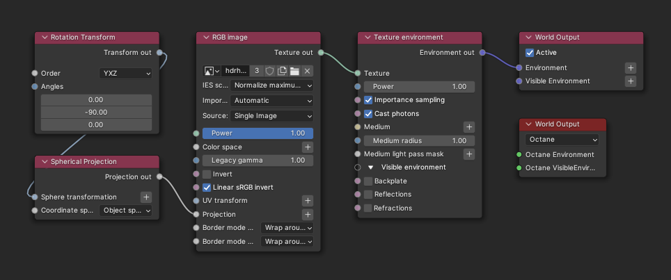

I updated to 28.4 from 27.16. Windows 10.
It immediately crashes Blender when trying to use viewport rendering. Octane server keeps working.
I suspect there might be some incompatibility with older nodes in the environment lighting. Since if I disable environment lighting, Octane works.

AlexeyAdamitsky
Posts: 105
Joined: Fri Oct 18, 2019 4:43 pm
It seems like 28.4 doesn't recognize the default (old) output node and crashing Blender.
