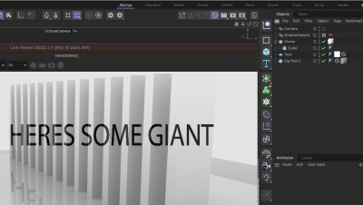

Does anyone know the correct camera mapping technique?

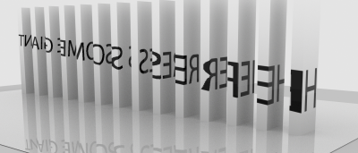

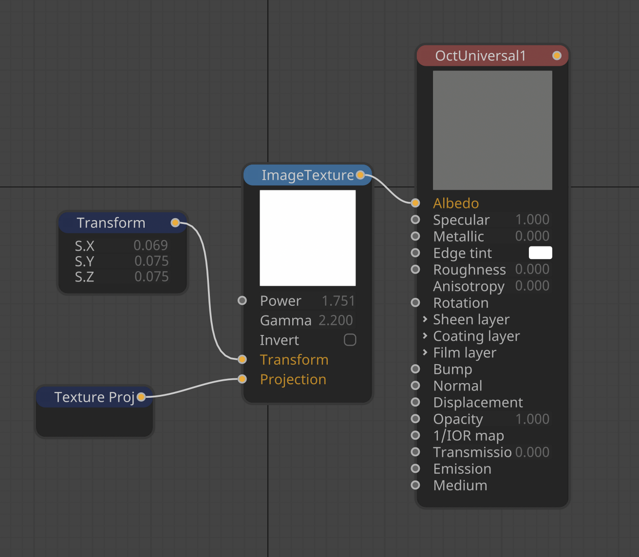

I am trying this way (pics attached) but the texture bleeds through to the other side, which is no good for me. I am trying to get to the technique also attached.
nodes
nodes

oh no it bleeds through
test scene
test scene

Easiest way to use Camera mapping from texture tag. Also perspective projection is another alternative.
