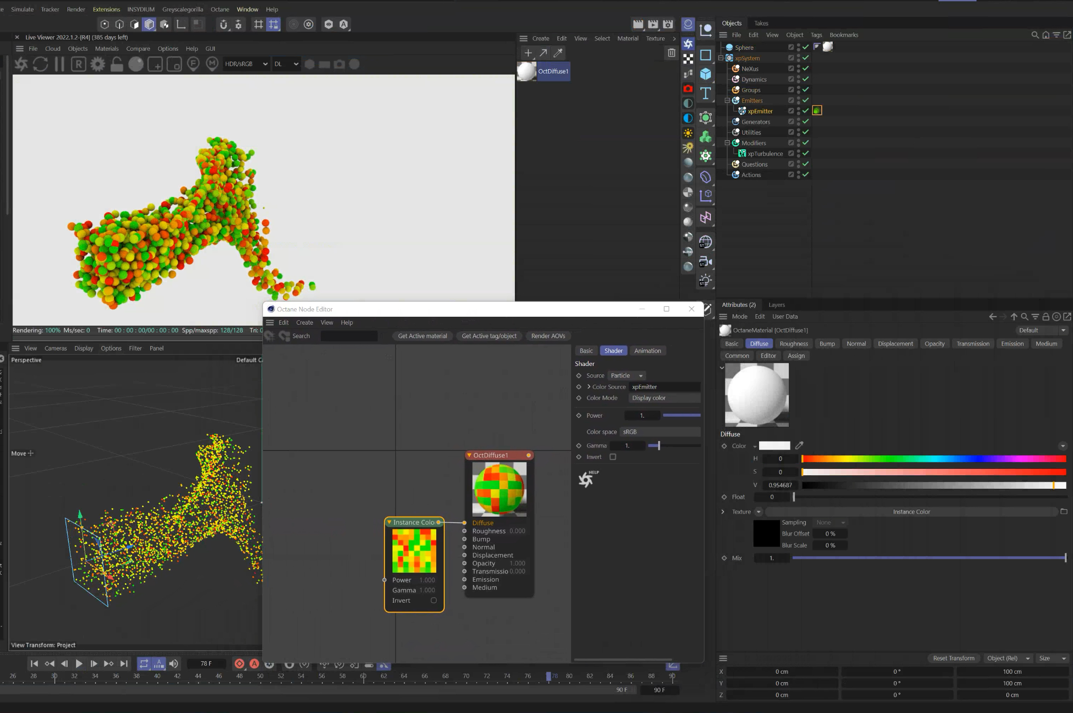

everything seems to work as expected here with Instance Color and X-Particles, in c4doctane 2022.1.2-R4:
Please try with this example scene and report back, thanks:

So it seems my/Octane's issue is a VERY specific one.
In the process of setting up a dummy scene, I realized, as bepeg4d just pointed out, that the Instance Color node was indeed working with XParticles.
The problem only showed up when I decided to emit from a vertex map like I was in my original scene....initially, this worked in my test.
However, it was only when I used a vertex map generated by xparticles using the "Vertex Map Source" utility did the problem show up again. This creates a vertex map tag on the object called VMSource.
I can delete the Vertex Map Source utility after the map is created, and the map remains, but it STILL brings octane/c4d to its knees. However, emitting from a regular vertex map created with fields works fine. This is annoying, but not detrimental to my project, as I will just created the vertex map another way.
Hopefully this helps someone else in a similar boat, and it would be great if the next Octane update had a fix for it.
