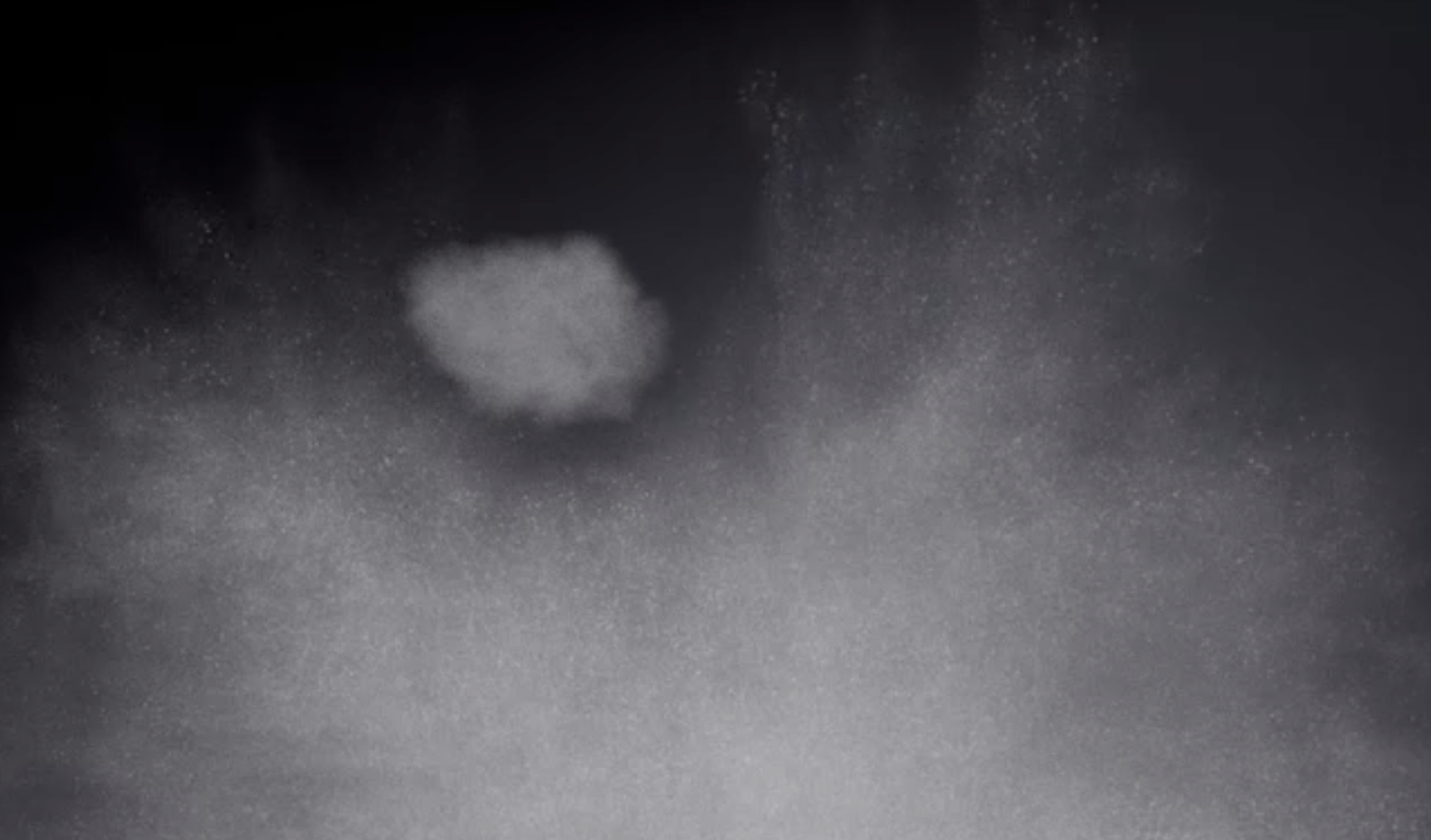

Edit: There is also another bug with animated alembic files and animated vdb sequences. If you scrub the timeline these sometimes do not update. This also happens if you render the animation.
As you can see here, there are multiple frames of the vdb sequence in one rendered frame.
Edit Edit: I noticed that too in Standalone, so maybe no plugin issue.
