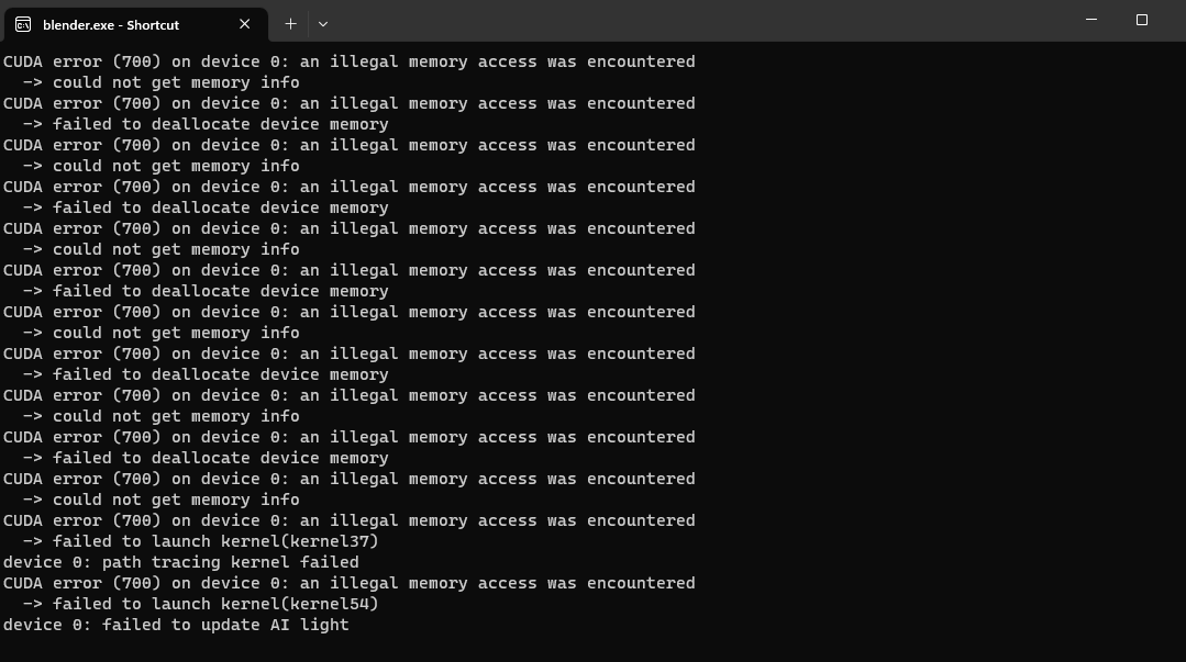

Lately when trying to render in the Viewport I've been getting this message in Console.... Please can someone give me some insight into what this error message means.
Grateful for any help.

CUDA error 700 is 99% related to Nvidia driver version.
Please perform a clean installation of latest Studio Nvidia driver, not Game ready, for your GPUs and OS version:
https://www.nvidia.it/Download/Find.aspx?
To perform a clean installation, please follow these steps:
After reboot, please download and run OctaneBench 2020.1, and share a complete screenshot of the result, thanks:
https://render.otoy.com/downloads/a/61/ ... _5_win.zip
If you still have CUDA error 700 with OctaneBench, you need to try with a different Nvidia driver version, until the issue is solved.
