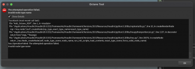

I got the Octane shelf to load, but when I click on any button, I get an error:
Octane button:
RTarget:
All other buttons give me "Unknown Command"
Octane button:
Code: Select all
Traceback (most recent call last):
File "Add_Octane_ROP", line 1, in <module>
File "/Applications/Houdini/Houdini19.5.716/Frameworks/Houdini.framework/Versions/19.5/Resources/houdini/python3.9libs/roptoolutils.py", line 10, in createRenderNode
rop = hou.node('/out').createNode(rop_type, exact_type_name=exact_type_name)
File "/Applications/Houdini/Houdini19.5.716/Frameworks/Houdini.framework/Versions/19.5/Resources/houdini/python3.9libs/houpythonportion/ui.py", line 1119, in decorator
return func(*args, **kwargs)
File "/Applications/Houdini/Houdini19.5.716/Frameworks/Houdini.framework/Versions/19.5/Resources/houdini/python3.9libs/hou.py", line 14562, in createNode
return _hou.Node_createNode(self, node_type_name, node_name, run_init_scripts, load_contents, exact_type_name, force_valid_node_name)
hou.OperationFailed: The attempted operation failed.

It looks like the Houdini.env paths are correct, but the plugin library wasn't able to load for some reason.
What is your mac hardware? The plugin is only built for apple silicon (M1/M2).
Are you able to run OctaneRender standalone 2022.1.2?

I just realised it was this old issue, macOS is blocking the plugin on startup
viewtopic.php?f=14&t=82611&p=428991&hilit=macOS#p428991
- ricky_otoy
- Posts: 289
- Joined: Mon Jun 19, 2023 6:34 am
Hi, yes that could happen and just allow under the security section. I assume you are all good to go now?snakeboxmedia wrote:I just realised it was this old issue, macOS is blocking the plugin on startup
- snakeboxmedia
- Posts: 140
- Joined: Wed Jul 11, 2018 1:09 pm
yes, it's all working fine, I had to allow it to access the dlls for both 19.5 and 20 and then restart houdini, all good.ricky_otoy wrote:Hi, yes that could happen and just allow under the security section. I assume you are all good to go now?snakeboxmedia wrote:I just realised it was this old issue, macOS is blocking the plugin on startup
