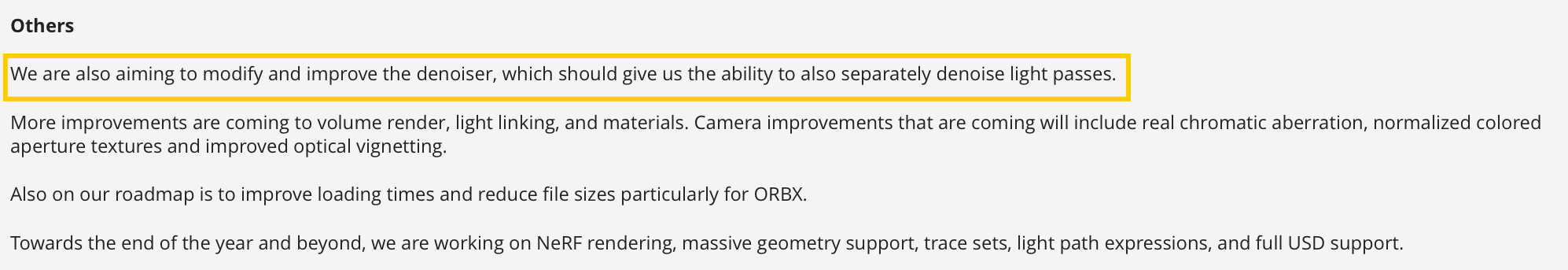

Beppe ... I'm happy to find that question already answered - just not the answer I was hoping for :(
Crossed fingers for 2023.2!

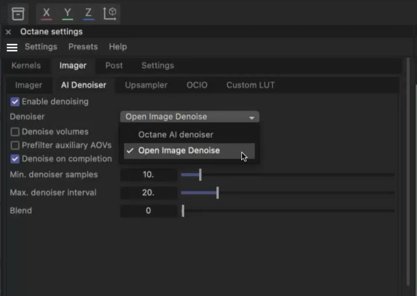

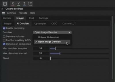

Posts: 10604
please have a look at 2024.1-Alpha1 release notes here:
viewtopic.php?f=33&t=82267
And in particular to "Powerful Denoise AOV Nodes and Filter Graphs (GPU and CPU)" paragraph.
This is possible thanks to the new "Open Image Denoise" option:
ciao,
Beppe
