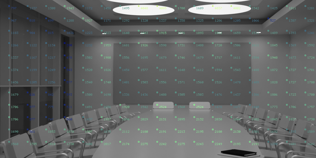

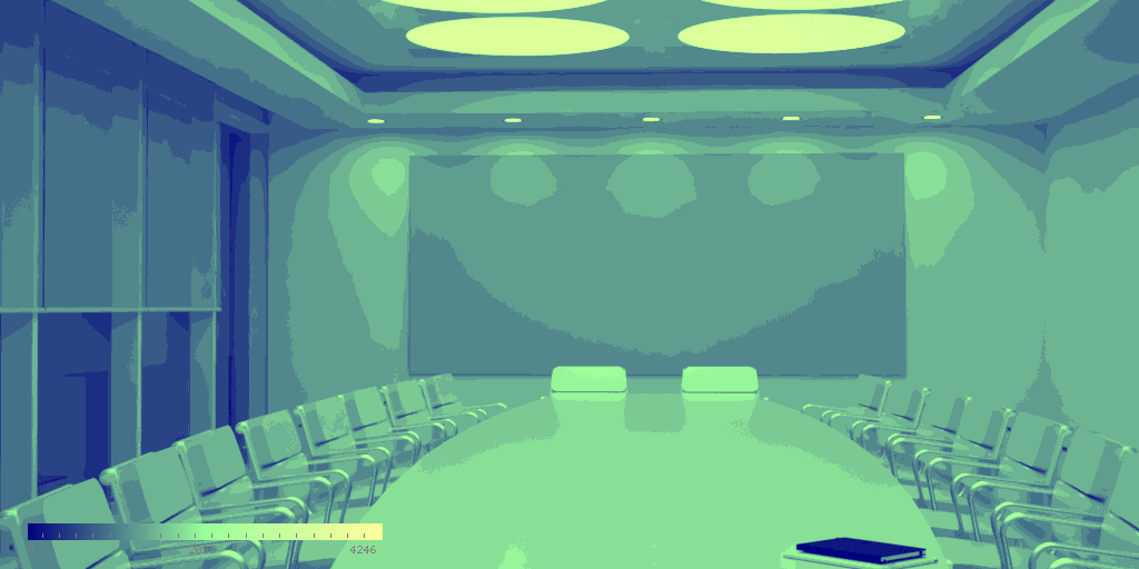

Please find attached a Lua script for analyzing an image in terms of Luminance. It is a first pass at the problem and is
in need of review by those with expertise. There is a post here with details of the math behind it, and some of the issues
that need validation.
viewtopic.php?f=9&t=82147
RenderTarget output with False Color contours themed by value
RenderTarget output with Sampling Grid themed by value
Image Luminance Analysis.lua
The Script
(149.72 KiB) Downloaded 121 times

Grid Sampling.
This function overlays a sampling grid on the image that reports the Luminance at the grid intersections.
The X and Y grid spacing in pixels and the color of the tic and text can be specified under the Settings Tab
There is also an option, on by default, to color the grid's Tic Mark and Text, based on the specified theme.
Thematic Analysis.
This function colors each pixel in the image based on where, in a user specified set of ranges, its value resides.
Under the Settings Tab, the Theme Count slider specifies how many color bands there will be in the final result.
The Lumen Range determines the variation in lumen values that will be included in a single band. The user can
change either one, however they are interconnected, increasing the Lumen Range reduces the Theme Count.
The colors to use are also specified here and are the inputs into a gradient used to color all the pixels
with a Luminance value from 0 to 45645(max lux per the LBNL Radiance equation).
This gradient is visible on the False Color Image tab, if you click on it, it will report the luminance value
represented by the underlying color, the ledgend can be placed on the image so you can generate pictures
suitable for inclusion in a written report. There is also a histogram on this tab which shows the number of
pixels in the image that fall within each band.
