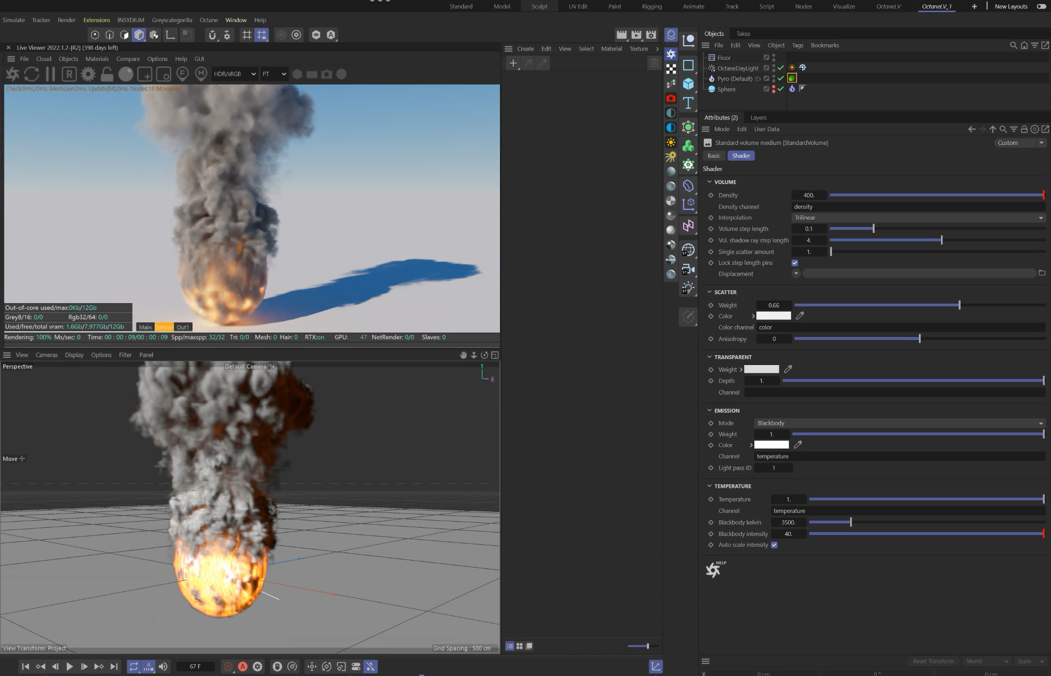

Hello all,
I would like to try Pyro as an alternative for TFD in C4D. When rendering in Octane, the Pyro flame image is significantly worse than TFD.
Also, the flame image in the viewport looks significantly better than the flame image after Octane rendering.
Is there some good settings in the Octane object tag can collect some tips here?
Looking forward to constructive answers.
Udo
Posts: 10618
Hi Udo,
you need to fine tune the Standard Volume Medium node to obtain the effect you want.
Have a look at this example here:
PyroTest_b.zip
(87.81 KiB) Downloaded 169 times
ciao,
Beppe
lehmannudo
Posts: 44
Joined: Tue Jun 01, 2010 12:02 pm
Thanks a thousand, this really helps me a lot
