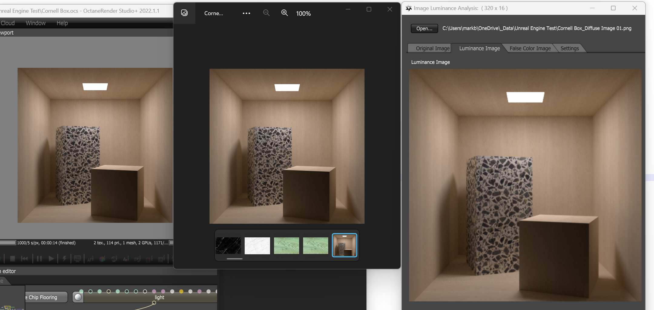

Size of bitmap does not seem to display scaled on screen as 1 bitmap pixel per screen pixel, it would be nice if it did.
Realestate on forms is tight and it would be good if these were not oversized.
Here is a 512x512 image showing the image at 1:1 in the Octane viewport, similarly next to it is the image in MS Photo,
and next to that is a Lua window with a bitmap component from which the previous image in MS Photo was saved. Note how much larger it is in the Lua bitmap component.And a bit fuzzy too.
Th lua bitmap sizes itself larger than the same image in other apps, including Octane standalone.
Can I control this?
Thanks, Mark

I'm curious if this is an issue related to High DPI, are you running at 150%? (Windows Settings - Scale and layout).

Yes, under display settings scale was set to 150% (recommended) by whom I don't know (Nvidia or Microsoft).
I have a 3840 x 2160, 60hz monitor, resolution is set to these values, scale is set to 150%.
Setting 'Scale' to 100% of course does not fix the issue as it is a problem of proportions.
It's a long time since I have had to deal with this in code myself, but I do remember there is something
relatively simple that can be done around reading the windows display graphics configuration and acting accordingly.
