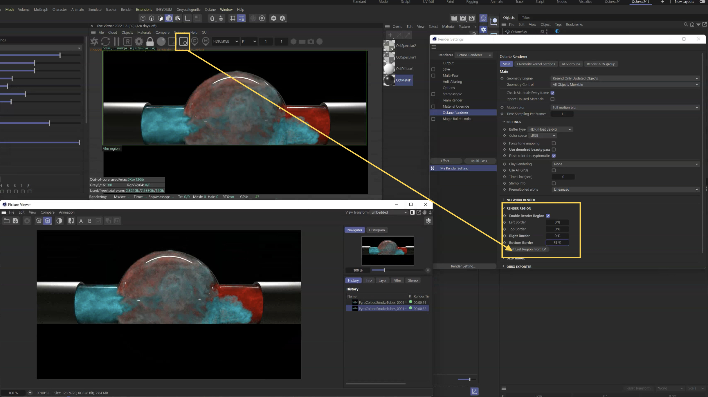

Well, the topic says it all really.
"Overwrite kernel settings" is unchecked.
Do I have to check some other setting?

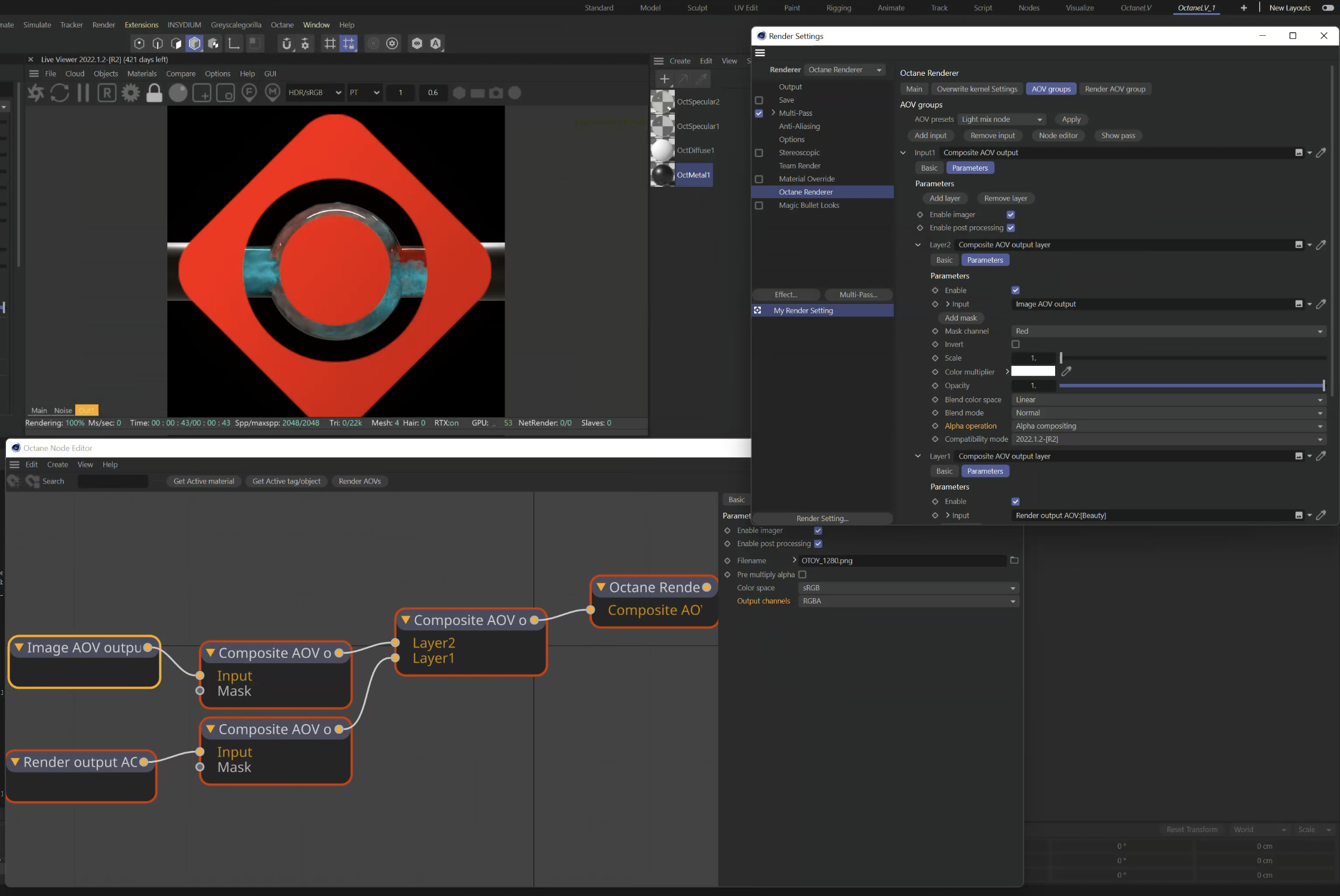

instead of using the C4D Foreground object, you can use the AOV group tab to add an image on top of your Beauty pass:

My idea was to "block" parts of the image I don't need by using a simple black Tiff with transparent parts.
The goal was to save render time, not to compose an image on top of the beauty pass.
In the Live Viewer it works as intended, but not in the Picture Viewer?

Hi Bepeg,
I know about film region and I use it. But with the foreground object I have freeform.
And as I said, it works in Live Viewer, but not in the Picture Viewer:
It's not that important, I was just wondering why it would work in the LV and not in the PV.

aoktar wrote:Give me your example scene then I will test it
There you go:
https://www.3dfisch.de/forum/foreground.rar
But it really is every scene with a foreground object:
LV:
PV:
Regards,
Marc

Looks like we haven't added the support for foreground in to final frames.
