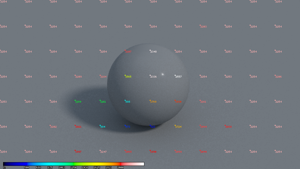

4) How would I go about writing the values taken at the sampling points into the bitmap image. There is no native graphics library
in Octane's Lua implementation (that I can see). I don't want an app that has a dependency on anything else to work. Do I need to
write a lightweight graphics library/module that is part of the script? This may be beyond me. Do I need to come up with a fixed pixel font
and create a function that writes into the image with setPixel the definition of each character, sounds slow to me.
is there a way to superimpose/float a label component over the bitmaps component with a transparent background.
Is there a way to overlay two bitmap components at the same location on a lua window? Is there something you can do with two buffers
in memory and blit them together at the end?

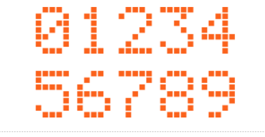

To draw Text I wrote a function that draws a string of characters into a bitmap image based on a string you give it.
It only does uppercase numeric characters so far.
Character set implemented to date
Here it is in case it is some value to someone.
draw digits function.lua
(41.75 KiB) Downloaded 479 times

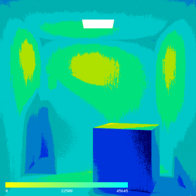

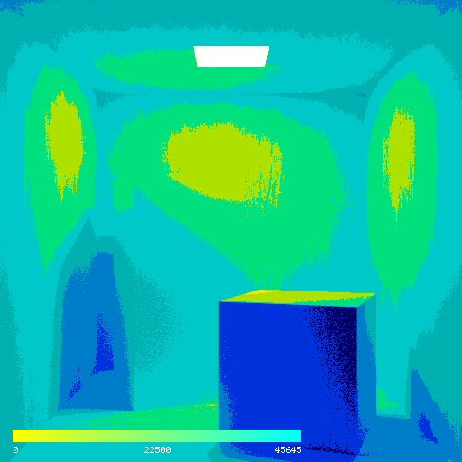

I got a legend working by creating a little bitmap in the GUI, filling it with a gradient using code and then using your copyRegion API call.
so problems 3) and 4) are solved. It looks like you have provided a path worth investigating for problem 1) & 2) so I'm hopeful. If I can get
these two I might be able to solve 6). Problem 5) doesn't look doable. I have done something like that in Widows as you can move controls at
runtime and stack them on top of each other, also you can use the Windows api to do transparent blitting of pixels.
I will want to go over the logic of deriving the luminance values with the community once the app is complete.
Its pulling info from pixels which means you have to set up the original/underlying rendering correctly (assuming you can)
including light sources that need to be emitting correctly. Here are some progress shots.
False color with legend

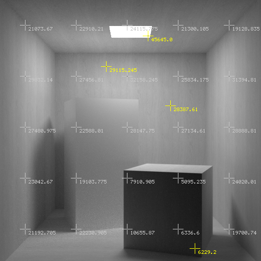

Luminance values on grid, and user selected locations
