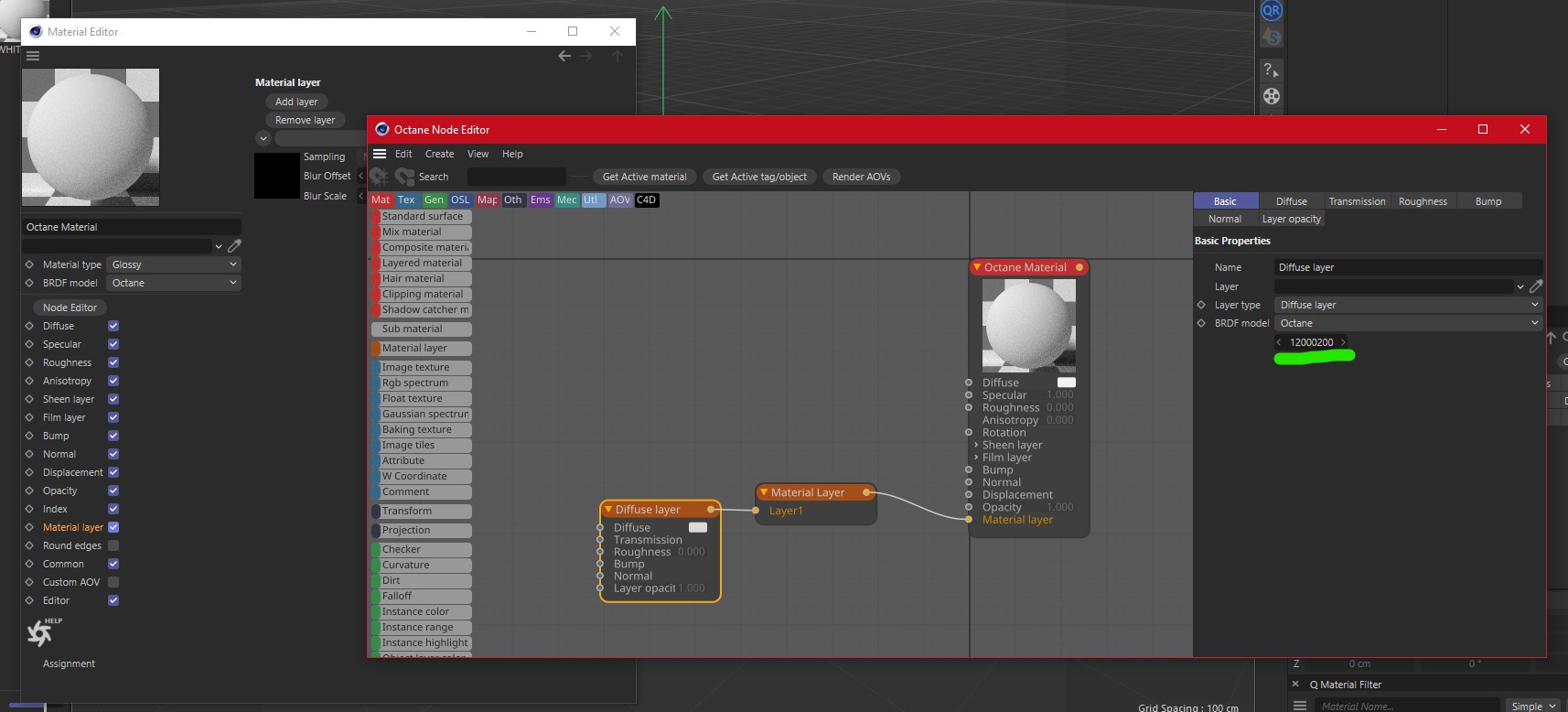

One question: what are these numbers I found in layered shaders?
Regards,

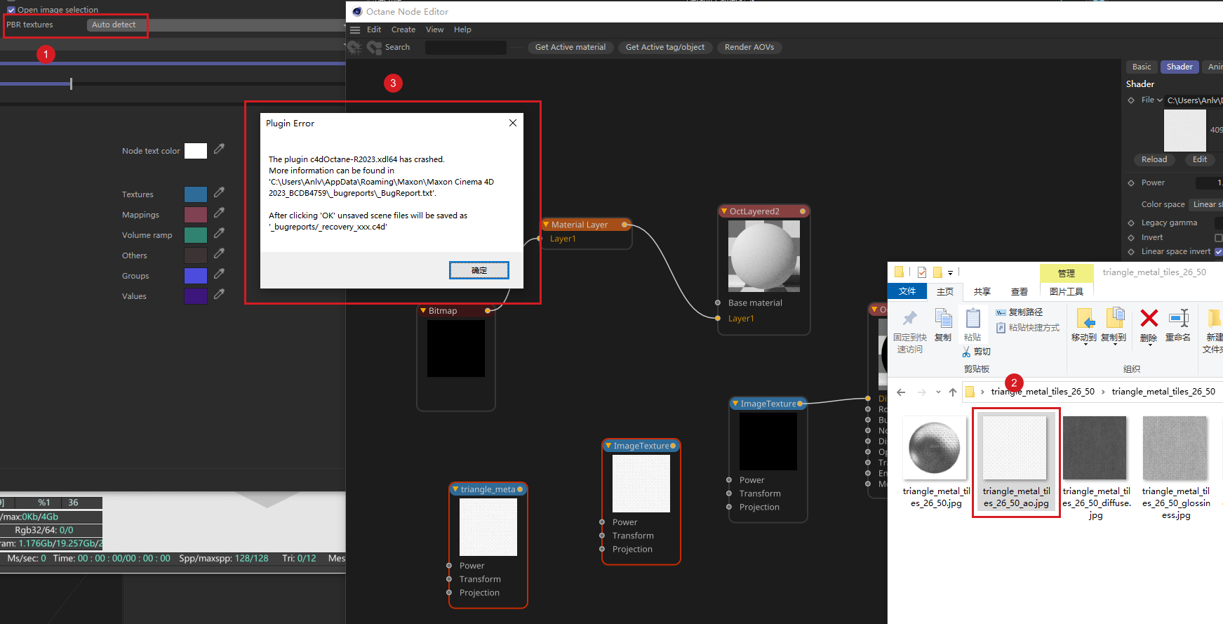

hi, aoktar
"Automatic PBR texture detection and import/connect to materials in Node editor. Plugin will create a set of images if you drop one PBR texture with defined syntax. Even will connect to material if you drop it over to the material. See settings/nodes/PBR_textures option."
When I open this feature and drag in a PBR image, Octane crashes.
The issue can be reproduced, and I will provide screenshots, screen recordings, and the BugReport.txt in the attachment.
2023-08-11 09-36-46.mp4
(4.22 MiB) Downloaded 18709 times
_BugReport.txt
(809.91 KiB) Downloaded 391 times
3D Motion Graphics Designer / E-commerce Designer
13700K / 64GB / 4090 / PSU 1250W

Kalua wrote:Hi, Aoktar!
Looks neat! Thanks for the update!
Regards,
Numbers from the compatibility attribute. It's not a part of 2022, it should be hidden.

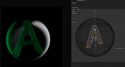

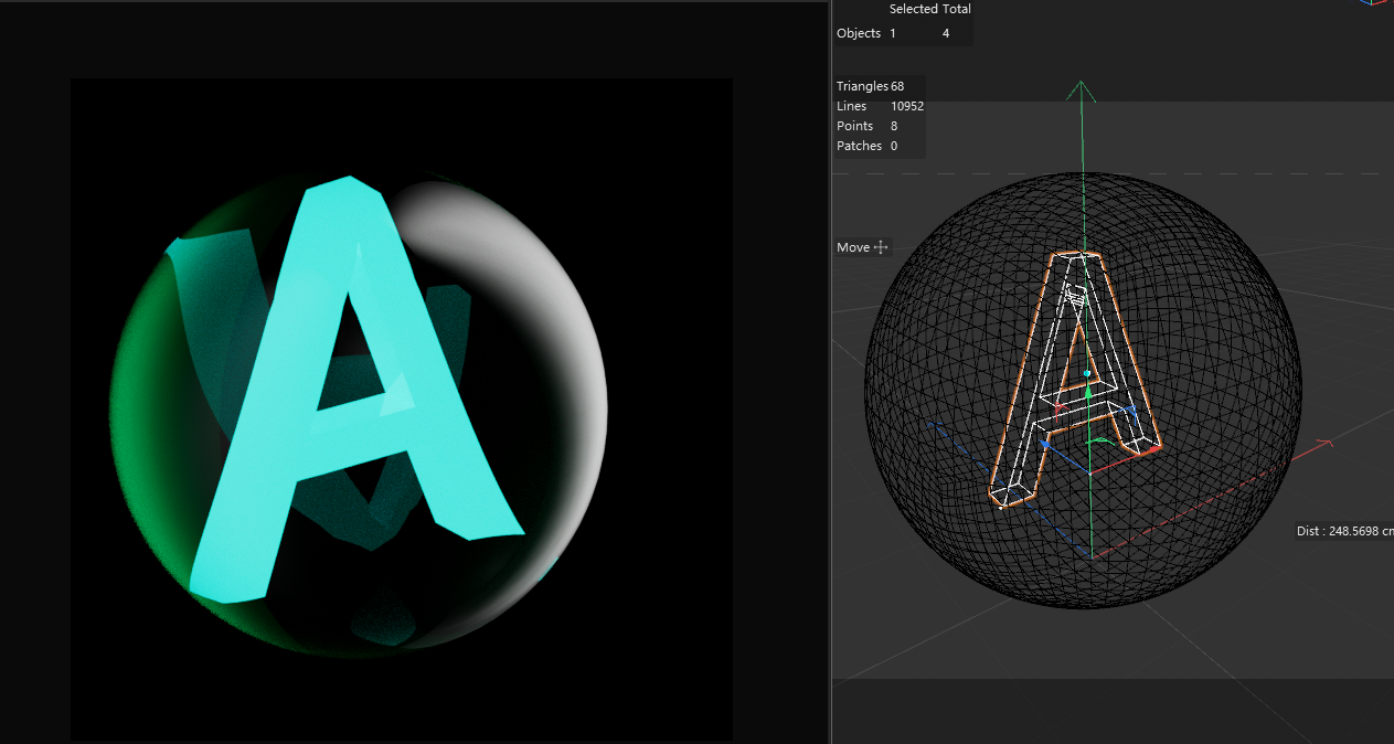

When a luminous object is placed inside the glass, abnormal luminescence will occur. As shown below. This situation can occur in:
1. When you save
2. When you adjust the glass color,3S property
3. When you adjust the brightness of the luminous object
4. Refresh the preview window
5. When moving the lens, the object
Anyway, this kind of loss of glow happens all the time!
[img]
Error
Error
[/img]
Under normal circumstances, this should be the picture below.
[img]
Right
Right
[/img]
So, I had to go back to 2022.1.1-R6
Problem _ Objects in glass emit light.zip
Problem _ Objects in glass emit light_C4d Project
(9.63 MiB) Downloaded 348 times

Anlv wrote:hi, aoktar
give a try with this new build
https://render.otoy.com/customerdownloa ... R2_win.rar

Hi, aoktar
Octane now does not show error messages, thank you very much for your help!
When I drag a diffuse texture into the Octane node editor, it also loads other textures together, which is great!
But it is currently not connected to the material?
Regards,
Posts: 16068
Location: Türkiye
Regards,
It will connect if you drop over the material node
Anlv
Posts: 26
Joined: Sat Jan 23, 2021 4:05 am
Location: China
aoktar wrote:
Regards,
Great, Now working as expected. Thanks again for your help!
