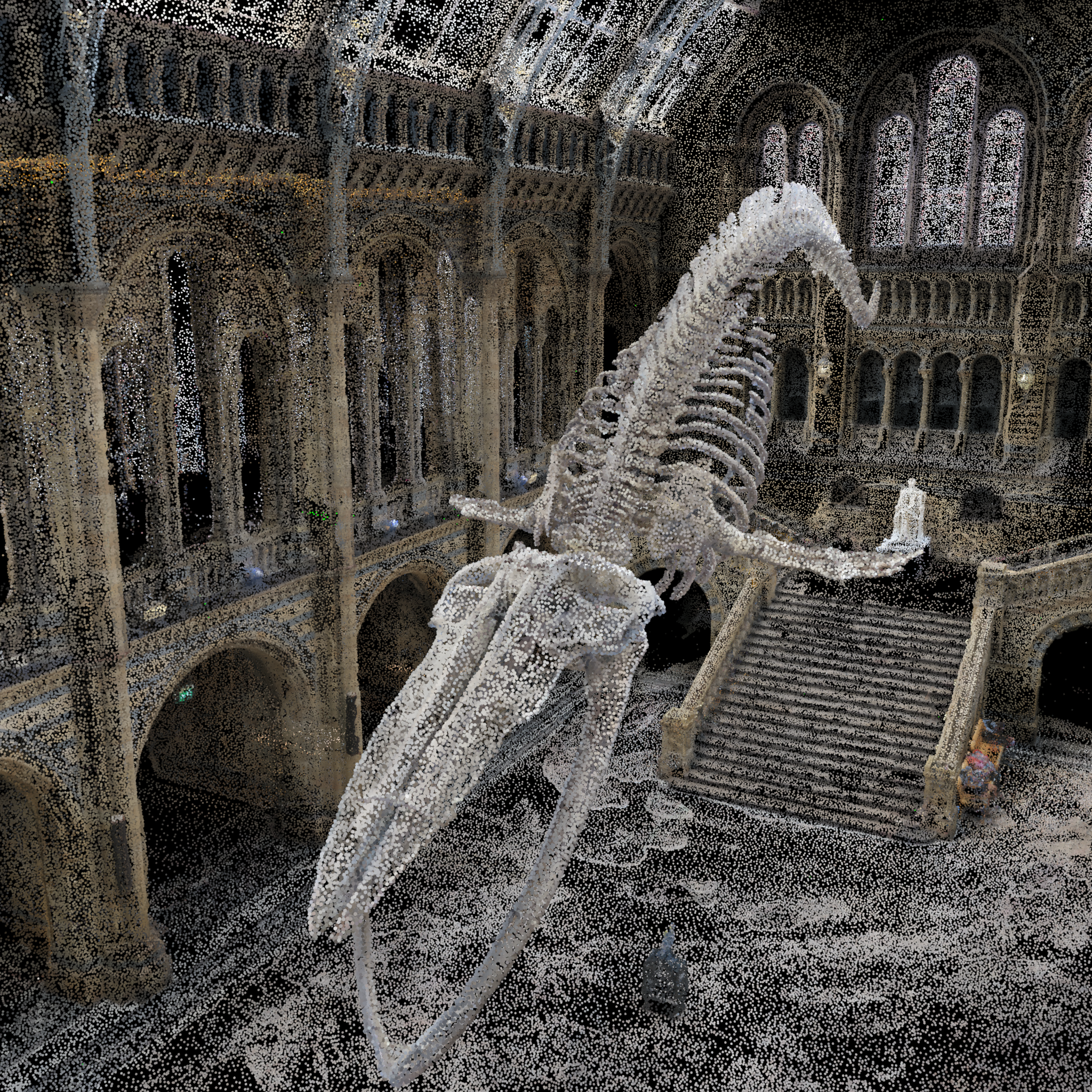

Rendered with Info Channels - Diffuse

For those of you who work with Scatter nodes and point clouds in particular, this .lua script can help.
A detailed description follows with a sample dataset to try out above.

As part of the processing step, the user can optionally have the script create a Node Graph of the all
the nodes required to display the point cloud. The script will create a scatter node and load the newly created
.csv file to locate each point. It will create a Vectron Sphere object, connect a Diffuse Material to it, and
import the Instance Color Texture and connect it to the material so that each point is appropriately colored.
A float value defaulting to 0.01 is also connected to the shere so that its radius can be controlled. The user
should set this to the desired value which will be based on the size of the point cloud's geographic extents,
Larger extents will require larger points. The sphere is connected to the scatter node, and the scatter node is
connected to a placement node. A ground Plane and Geometry Group are also included.

Below is a sample of the first few lines of a .ply file containing a point cloud. It contains point location
and rgba data that we can use, however there are three additional substrings in each line, defined in the Header
as floating point numbers, nx,ny,nz all of which are less than 1. The script cannot process these and currently
they need to be removed using an ascii text editor such as Notepad++, or using the built in Column Selection feature.
ply
format ascii 1.0
comment VCGLIB generated
element vertex 2026712
property float x
property float y
property float z
property float nx
property float ny
property float nz
property uchar red
property uchar green
property uchar blue
property uchar alpha
element face 0
property list uchar int vertex_indices
end_header
-177714.5 -929289.9 2028.838 0.03822402 -0.003634897 0.09233478 84 75 73 255
-177715.1 -929291.8 2024.964 -0.02729818 0.01025391 0.09565389 18 17 17 255
-177715.3 -929291.6 2024.841 -0.07316666 0.004162515 0.06803906 19 18 18 255
