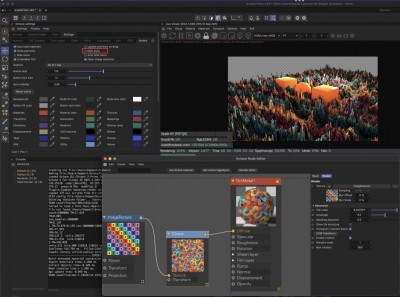

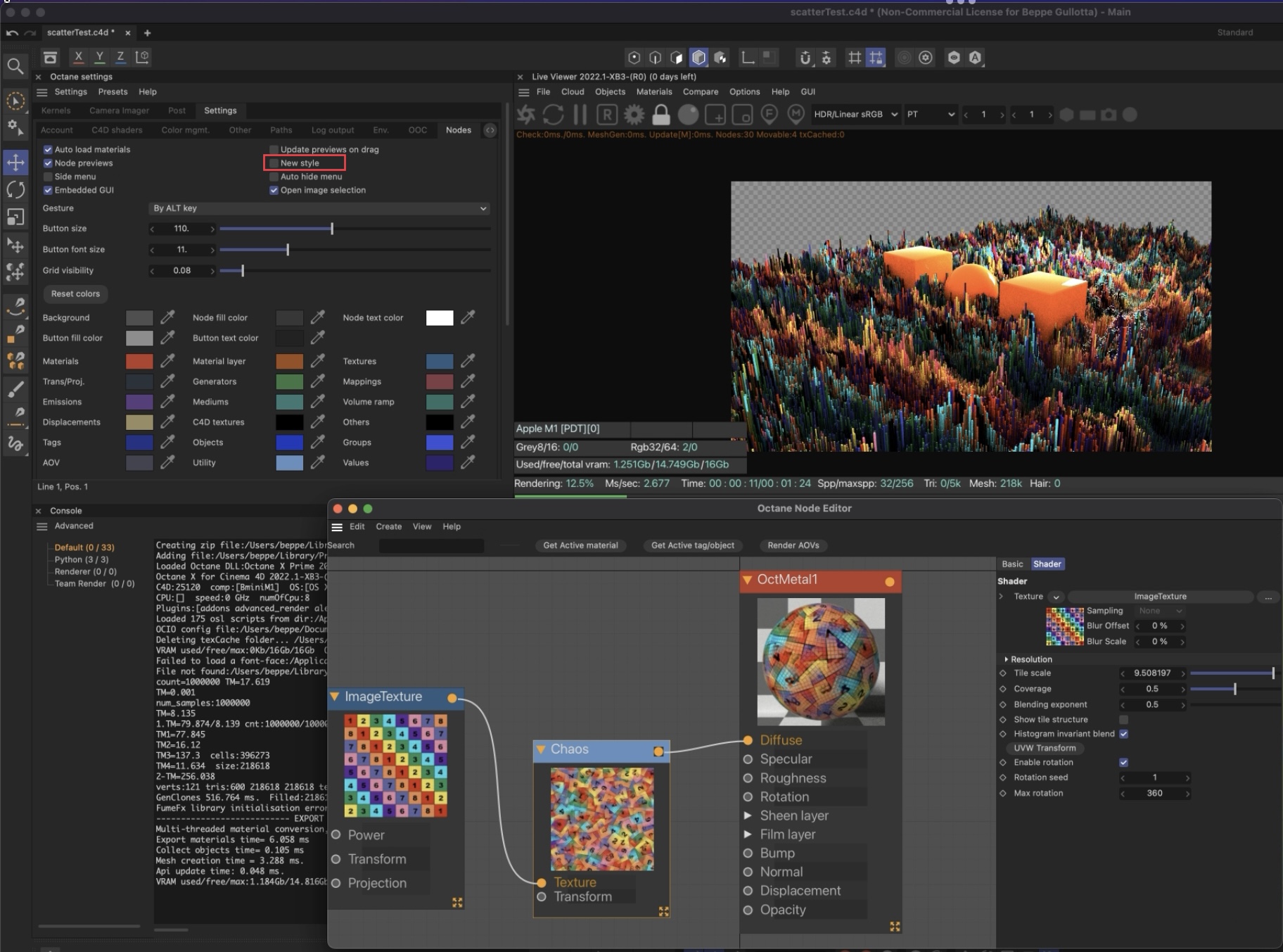

about node editor previews, you need to go to c4doctane Setting/Nodes, and disable the New style option, or material preview doesn't work in node editor:

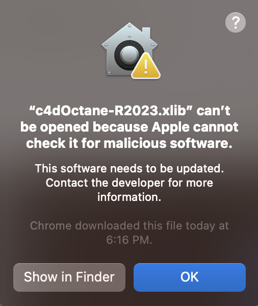

I keep getting this. Octane X demo. Mac studio, m2 Ultra. I saw octane icon but when tried to render the wheel spun, had to force quit and ever since this is what i get. Any help? I have followed video instruction on tweaking terminal but that doesnt work.
Posts: 10598
this error message is expected, you need to allow the c4doctane plugin and library in System Preferences/Security and Privacy panel, and restart C4D a couple of times:
